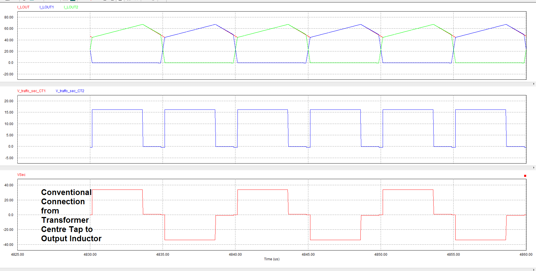

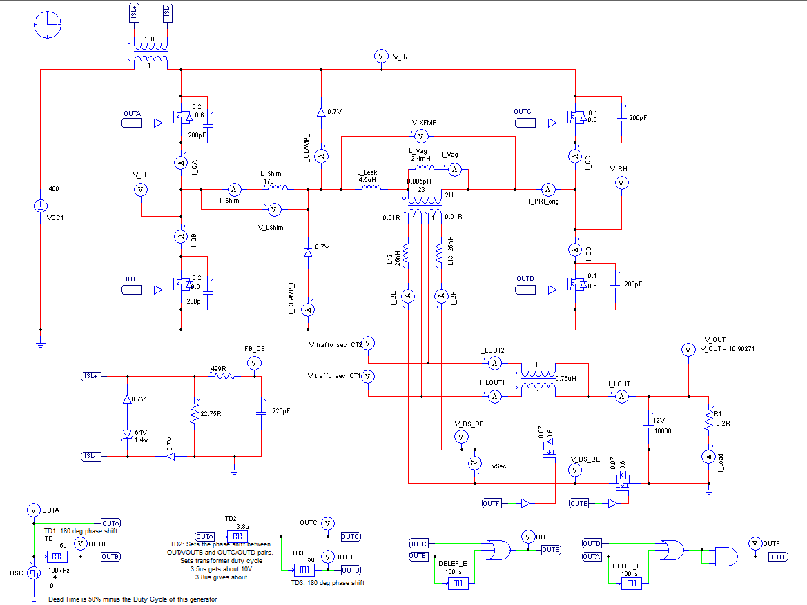

Iam designing 7kwt converter using ucc28950 and i whant expert advice if i can leave secondary windings separate before dc choke (end and begining of two secondaries are connected in datasheet),put wires form secondaries right throug a choke and connect them togeather right after a choke on a filtering capacitor?
reason why i ask if it will work fine or not is that i have to strip 150 separate emalled copper wires in order to connect them togeather at that point before a choke,and thats a peace of a work,which is not the joyfull one.
the other part of question may be: does each secondary wire carry the whole output current?
