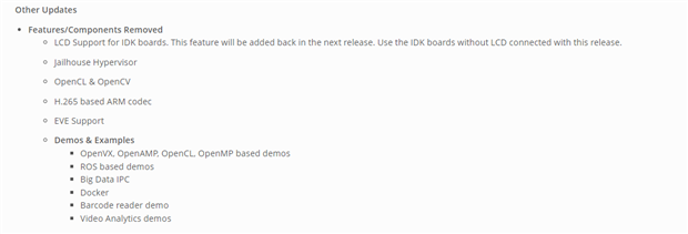

Hello all, I updated my question.I simply want to run sample OpenCL applications with Processor SDK Linux 06_03_00_106 on a custom board with AM5729 installed, but the console keeps getting

Changes I made:
1.I changed to cmem size to 0x18000000 in am57xx-evm-cmem.dtsi
2.I added the patch located here to uboot.
lists.denx.de/.../472361.html
I suspect a problem with the opencl-monitor firmware under /lib/firmware. Is there anything extra I need to do to initialize the IPUs?
