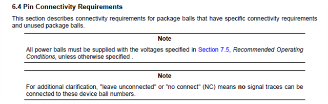

Hi Sreenivasa - To clarify on your comment above. If the RSVD pin calls for a GND connection, then the RSVD pin should be connected to GND. Is that correct?
As an example, the RSVD_t4 and RSVD_U1 pins from the AM2633-Q1 datasheet (shown below) state they should be connected to GND.
Hello Jacob Wytick,
Thank you for the inputs.
Please review the title of the FAQ. The FAQ is specific to the Sitara AM62x family of processors.
We do not have any of the AM62x device RSVD pins that has recommendation to connect to ground.
