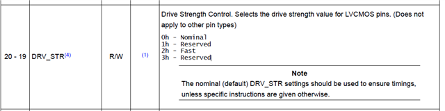

  • Hi Board designers,
    Inputs related to drive strength for AM62L
    Please refer below table of the processor-specific TRM for information related to drive strength (Dual-voltage IOs, For LVCMOS Buffer Type Only) or slew rate (Fixed-voltage IOs, For 1P8-LVCMOS Buffer Type Only) configuration supported:
    Pad Configuration Registers
    Pad Configuration Register Functional Description
    The pad configuration registers are used to configure most of the device pads. Each pad configuration register is
    associated only with one pad and has bits as described in Table 14-3860.
     Description Of The Pad Configuration Register Bits for AM62L IO pad configuration:
    Nominal impedance
    Dual-voltage IO buffers
    SDIO Buffer - 40Ω
    LVCMOS Buffer NOM- 60Ω
    LVCMOS Buffer FAST - 50 Ω
    The above is valid for AM62x, AM62A, AM62P, AM64x, AM243x
    Fixed voltage 1.8V IO buffers (AM62L):
    1P8-LVCMOS Buffer – 50 Ω
    AM62A
    (4) Use of settings other than the reset value could invalidate datasheet timings.
    Note:
    The IO buffer output impedance is valid when the IOs are operating (operating voltage) at 1.8V or 3.3V
    The IO buffer output impedance is valid when the IOs are operating withing the ROC as per the processor-specific data sheet for a given operating voltage.
    Note:
    We are working to enable a faster drive strength option, but there is no plan to support a reduced drive strength mode.
    timeframe or ETA for the faster drive strength feature
    I do not, it is currently down to alignment for an SDK release to contain the feature as this has to be supported and enabled in SW.
    Sreenivasa

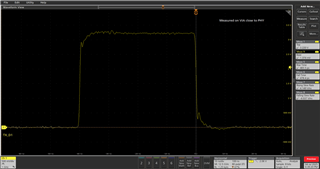

    We designed in our PHY and AM64 at our customer.
    The latest assessment shows that there might be some issues with our spec:
    We were taking some measurements on our board where we use the AM6422 and DP83822 PHYs and I noticed some values that I was wondering if you could help me clarify.
     In the AM6422 Datasheet I see the information below:
    Looking at our PHY:
    I attached a sample measured of RX_D1 and TX_D1 as references, but similar timings are observed on all relevant signals:
    As you can see above, when it comes to the TX signals the requirements are fulfilled both for the processor and the PHY.
    This is, unfortunately not the case for the Receive signals, so my questions are :
    1. Why is this requirement from the processor so restrictive?
    2. Would this timing from the RX line cause an issue with the processor?(lost frames etc.)
    3. Could this be somehow be adjusted by the processor or the PHY?(Driver strengths or timing parameters)
    The minimum input slew rate defined for AM64x is equivalent to the input rise/fall time requirements defined for the PHY. A 20% to 80% or 80% to 20% voltage change is a voltage change that is equal to 60% of VDD. In your case, VDD is 3.3V and 60% of 3.3V is 1.98V. Changing the signal by 1.98V in 0.75ns gives a slew rate of 1.98V/0.75ns = 2.64V/ns. So, the requirements are the same for both devices and matches the signal rise/fall times defined in the RGMII standard.
    Measuring the rise/fall time at the source end of an LVCMOS signal can be misleading. The voltage at the source end of the signal only steps up to a mid-supply potential until the signal has time to propagate down to the far end of the signal trace and the high impedance connection at the far end returns an in-phase reflection to the source. Therefore, measuring a 20/80 rise/fall time at the source will include 2x the PCB trace propagation delay in your measurement. The far end of the signal trace doesn't see this additional delay. I suggest you find a place to probe the RX_D1 signal near the AM64x device to get an accurate rise/fall time measurement for the RX input. Otherwise, you could subtract about 0.334ns for each inch of signal trace from the measured value at the source to get a value that is close to what is seen by the RX input. For example, you would subtract 1ns from the 1.7ns fall time measurement if you have 3 inches of PCB trace between the probe point and the RX input pin.
