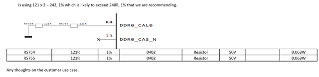

    Feedback from the IP owner is that the RCALIB resistor should not exceed 1% at any operating condition for the lifetime of the product. This applies to both USB and CSI.
    What is the lifetime requirement for resistor tolerance on DDR0_CAL0 (pin H6)?
    Yes, it has a similar lifetime requirement that the DDR0_CAL0 resistor has to stay within 1% tolerance
    You mentioned we should use alternate resistor for our evaluation - Does this means we have to use a resistor whose tolerance is with in 1% throught out temperature , throughout lifetime. If yes then I don't have any further questions :-)

    As with any other requirement, if the violate it, they’re just adding more risk in their design.  In this case, IO calibration on the processor, which runs periodically in the background, will be compromised.  I wouldn’t recommend it.
