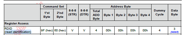

While integrating OSPI NOR Flash from Macronix, customers have faced flash errors.
Here are the top two concerns faced:
- The most common error being: The OSPI Controller fails to read the Flash's manufacture and device id.
- The second one being not able to operate in 8D-8D-8D and read and write from/to the flash after Step 1 problem is resolved.
Let us understand how to go about debugging this in detail.
