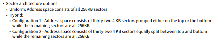

  • What is Uniform vs Hybrid Mode for the flash.
    There are two modes/configurations in which the flash part can be set.
    In the context of the two flashes mentioned, these configurations are Hybrid and Uniform mode.
    Please note that the writes and read operations are independent of the two configurations mentioned.
    But the difference lies in how erase is operated.

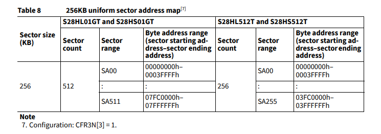

    When in Uniform mode:
    1. The sector size is 256 KB, hence we call it a block. So, one way to think of it is Block size > Sector Size.
    2. When we perform sector erase, we are essentially doing block erase of 256 KB.
    3. So at a time, a 256 KB block will be erased and therefore you can see all values in the erased 256 KB area to be set as 0xFF.

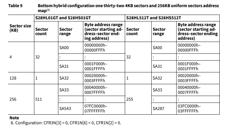

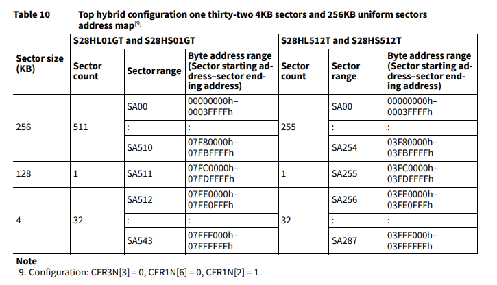

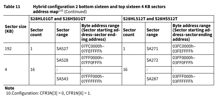

    When in Hybrid mode:
    1. The sector size is a mix of 256 KB and 4 KB. So the 256 KB can be referred as Block and the 4 KB space can be considered as Sector.
    2. When we perform sector erase, we can perform either:
      1. Block erase of 256 KB, or,
      2. Sector erase of 4 KB.
    One combination of Uniform mode is:
    All the possible combinations of Hybrid mode are:
