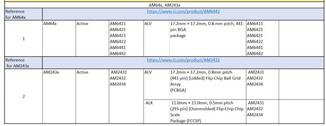

Part Number: AM6442
Hi TI Experts,
Please provide list of packages supported for AM64x and AM243x processor families
Part Number: AM6442
Hi TI Experts,
Hi Board designers,
Refer below.
Sreenivasa

Hi Board designers
refer below for the supported collaterals for available packages.
AM64x (ALW) and AM243x (ALW, ALX)
Supported collaterals
