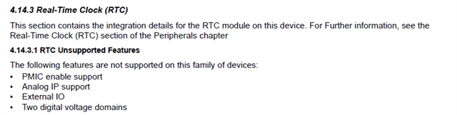

AM625-Q1: RTC reset during soft reset
On AM62, RTC will not retain its time value during a software reset. This is because RTC is not integrated with any reset or voltage domain crossing in AM62.
None of AM62, AM62a, Am62P etc. have a persistent domain for storing the RTC time value across a main domain reset.
As an exception, if the Deepsleep low power mode is entered correctly, then RTC should retain its time value and keep counting during Deepsleep on AM62 and AM62a. This is an exception only insofar as the main domain is in PORz reset while AM62 is in Deepsleep.
I would like to clarify your understanding of the TRM. The item you are quoting is formatted like this:
The logic designer’s intent here was that, if RTC were integrated with the analog IP block, then RTC has two digital voltage domains. Otherwise, if RTC were integrated without the analog IP block, then RTC has only one digital voltage domain. Unfortunately, the TRM does not indicate to me whether or not RTC is integrated with support for the analog IP block. In order for RTC to properly support having an “always-on” time counter, RTC needs to be integrated with support for the analog IP block so that it has two digital voltage domains. Without that analog IP block support, RTC cannot implement the voltage domain crossing which is needed to have an always-on time counter while the system interface portion of the RTC module is powered down. I think that the formatting of the text here does not convey well the intent of the logic designer.
The pre-silicon module integration document indicates:
My understanding is that this specific phrasing is not absolutely accurate with regard to the ability to set a timer using this RTC module during the Deep Sleep low power mode. However, this is accurate with regard to whether RTC has a truly always-on portion. RTC on AM62x does not have two digital voltage domains nor does it have an always-on time counter.
The TRM for AM62x should indicate that “analog IP support” and “two digital voltage domains” are unsupported features for RTC. I hope that this would clarify the misunderstanding that led to this e2e ticket. The same should be applied to basically every other device TRM which contains an RTC module except for AM62L, which is currently the only exception that I know of.

TRM reference for RTC module (Valid for AM62x, AM62Ax, AM62D-Q1, AM62Px)
