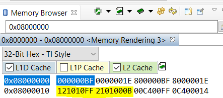

    more strangeness from this end.
    I have been trying to set the XMC MPAX as you suggested, but it always displays as zeroes in the memory browser.
    Ihave been using the folowing sequence to set the register values.
    uint32_t *reg = 0x08000010
    *reg = 0x121010FF
    ++reg
    *reg=0x2101000B
    The memory from 0x0800_0000 is displayed as 0000_0000 in the memory browser window and if I hover over the data, the message "Target failed to read 0x0800_0010" is displayed.
    I looked at the memory map set up in CCS. It is set using the command
    GEL_MapAddStr(0x00000000, 0, 0xFFFFFFFF, "R|W|AS4",0)
    I have tried replacing the access string with "R|W" and with "RAM"
    I have also tried setting up the cache.
    None of these make any difference.
    Incidentlly, I don't see the cache check boxes in the Memory Browser window.
    thanks
    dan
    You have several issues need to be resolved in order to test K2E ECC interrupt on ARM core.
    1) Make sure DSP C66x (not ARM A15) core 0x0800_0000 region is accessible via JTAG/CCS memory window.
    I just tested on a TI K2E EVM with the standard GEL under ccs_9_0_1\ccs\ccs_base\emulation\boards\evmk2e\gel and there is no issue, you don't have to modify the GEL_MapAddStr.
    MPAX set up is for DSP core (NOT ARM CORE), that makes you are able to read the EMIF config like below (non-zero) at 0x21010000

  • Hi Eric,
    The processor is an AM5K2E02, so there's no DSP core.
    thanks
    dan
  • Dan,
    Even there is no C66x core, I tried TI K2E EVM (it has C66x ) by connecting to A15_0 directly, then look at the address (32-bit address) 0x2101_0000, I can still see the correct value for EMIFCFG.
    All I need is to run the GEL file on A15:  \ccs_9_0_1\ccs\ccs_base\emulation\boards\evmk2e\gel\evmk2e_arm.GEL. You can see that GEL file configures the DDR, it has code like

    No matter what versions of data sheet, the region of 0x0800_0000 is for the XMC configuration. And I just ran the GEL file on ARM core, ========>Global_Default_Setup_Silent()=======>xmc_setup():
    xmc_setup()
    /* mapping for ddr emif registers XMPAX*2 */
    XMPAX2_L = 0x121010FF; /* replacement addr + perm */
    XMPAX2_H = 0x2101000B; /* base addr + seg size (64KB)*/ //"1B"-->"B" by xj
    GEL_TextOut("XMC setup complete.\n");
    This setup the EMF configuration.
    It is true that if I looked at the ARM CPU view of 0x0800_0000, it is 0. But if I look at the AM CPU view of 0x2101_0000, it is correct value.
    So, at least you need to make sure you can duplicate what I saw here: using GEL file running on ARM core 0, you are able to see the EMIF configuration correctly at 0x2101_0000. This is tested on K2E EVM  with 66AK2E05, we don't have EVM with 66AK2E02, but I believe this should be the same behavior.
    Regards, Eric
  • Hi Eric,
    We have five 16-bit DDR3 chips on our board.
    I still can't read the XMC values at 0x0800_0000, but I can read the EMIF values 0x2101_0000. I can configure the DDR3 and the addesses from 0x8000_0000 are accessible.
    Using my version of the evmk2e_arm.gel where I have adjusted the DDR3 parameter values to match our board, I have added some functions to enable the ECC. At the moment there are very basic and should just enable the ECC, write a 64-bit value and then disable the ECC and modify the value before re-enabling and testing.
    The caching is not enabled.
