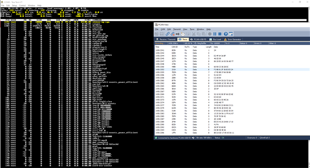

  • Hi Karan.
    I have attached the result of additional test for this issue.
    1. test with cangen only
    I executed the below command for writing CAN test.
    cangen can0 -g 0
    The issue is not reproduced for 1 hours.
    2. test with cangen + application
    1) I ran SV application ( CAM -> TIDL -> Post(A72)) without any CAN related functions
    2) execute cangen can0 -g 0 after starting the application
    cangen is blocked within few minutes.
    The application didn't execute any CAN related work, but cangen is not working soon.
    Dongwon Choi

  • Hi Karan
    I read PSR register again with devmem2 command after cangen is not working.
    [reproduce step]
    1. run SV application
    2. run cangen can0 -g 0
    3. monitor incoming CAN messages with CANape
    4. I read PSR register with devmem2 when I find out  CAN message is not sent to CANape.
    [PSR register]
    root@j7-evm:~# devmem2 0x40528044 w
    /dev/mem opened.
    Memory mapped at address 0xffffb7c20000.
    Read at address 0x40528044 (0xffffb7c28044): 0x00000708
    /dev/mem opened.
    Memory mapped at address 0xffffbd410000.
    Read at address 0x40528044 (0xffffbd418044): 0x0000070F
    Is it appropriate way to read PSR register at my side?
    Please let me know there is other way to read PSR for this issue.
    Dongwon Choi

  • Hi Dongwon Choi,
    I ran this test almost 30mins and did not see an issue. See below screen:
    Another thing to note is that even when you hang, you never get a protocol error. The error where write() returns EAGIN and Resource temporarily unavailable is printed - this may hence purely be a socket related error.
    There was however a case the other try where my A72 somehow hanged when running both together, I don't think that is what you observed.

    Additionally, I have attached the modified cangen binary and source code(cangen, cangen.c).
    cangen_modified_20210701.zip
    I modified cangen for working wth non-blocking mode.
    I've reproduced this problem at RVP board within 10 mins
    It took about 2 hours at EVM board.
    Can you check the below step with the attached binary?
    root@j7-evm:~# sudo stress-ng --cpu 2 --timeout 0 &
    [1] 1677
    root@j7-evm:~# stress-ng: info: [1678] dispatching hogs: 2 cpu
    root@j7-evm:~# cd /sd/can-utils/
    root@j7-evm:/sd/can-utils# ./cangen can0 -g 0
    ======= modified cangen non-blocking mode started ==========
    [ 55.423659] can: controller area network core (rev 20170425 abi 9)
    [ 55.435277] NET: Registered protocol family 29
    [ 55.457628] can: raw protocol (rev 20170425)
    errno = 11
    write: Resource temporarily unavailable
    You can see errno and reason if you can reproduce this issue at your side.
