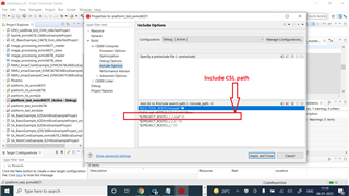

  • Brad,
    1. Make sure you use the CCS version - 9.3
    2. In your log, it shows undefined errors about CSL . Please check and  include the path of CSL package in the project properties.
    Shankari G

  • Brad,
    One important thing, before building the "platform test", you have to build the "platform lib", as I have shown in the video.
    Have you built the platform-lib ? that is required for platform test...
    1. Attached the build log here,
                   1. Build log of platform lib -
