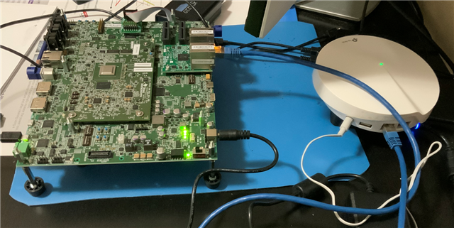

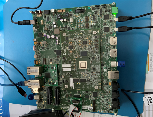

EVM boots QNX image but we don't see any logs related to ethfw.
It looks like the above images in Blue for R5F are available on the file system but how do they get loaded?. Please find the logs below and let us know if there are any steps to load the ethfw on the R5 core ?

  • Thank you KB!
    Could you please let me know how can I check logs when ethfw is running?
    I tried all available UART ports( main (2,3,4), mcu(5,6) ) but I did not see any logs
    uboot env variables
    rproc_fw_binaries=2 /lib/firmware/j7200-main-r5f0_0-fw 3 /lib/firmware/j7200-main-r5f0_1-fw
    rproc_load_and_boot_one=if load mmc ${bootpart} $loadaddr ${rproc_fw}; then if rproc load ${rproc_id} ${loadaddr} ${filesize}; then rproc start
    cpsw2g works fine. ( Static and DHCP address )
    When we start cpsw5g driver with ethernet cable plugged into LAN
    J7200-EVM@QNX:/# io-pkt-v6-hc -d cpsw5g

    Setup information: We are using the QSGMII version of the ethernet daughter card.

    • Correct, what I meant is we only have one ethernet cable connected to the QSGMII daughter card port at any time ( We tried all 4 ports one after another )
    • We only enabled cpsw5g driver ( cpsw2g not running )
    For the above description, it is not clear what is being done.
    • When ethernet cable is plugged into LAN network + power on the board + start cpsw5g driver we don't see ETHFW messages
      • After starting the driver ( io-pkt-v6-hc -d cpsw5g ) the last message is
        • Jan 01 00:02:59.098 io_pkt_v6_hc.77837 slog 0 CPSW5G: Attach to CpswProxy Server.
    • When the ethernet cable is unplugged  + power on the board + start cpsw5g driver we saw ETHFW messages

    Test setup EVM -> Mesh router port (cpsw2g works , cpsw5g doesn't seem to work )
    PATCH RESULTS:
     1. uboot +QNX + RTOS TISDK 8.1 ( We use uboot for our development )
    • UART logs are now displayed
    • No luck with cpsw5g .
      • Our set up as indicated above uses uboot + QNX + RTOS images - TISDK 8.1
