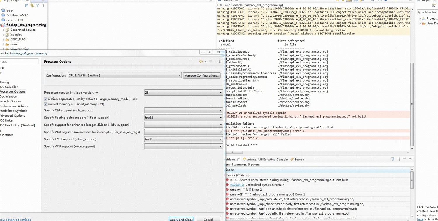

Hello Champs,
I'm asking this for customer. The CCS version used by customer is CCS 10.2, C2000ware version is C2000Ware_4_00_00_00, and the device is TMS320F280025.
Customers say they now import F280025 example code will report errors.
After importing the project (C:\ti\c2000\C2000Ware_4_00_00_00\driverlib\f28002x\examples\flash\flashapi_ex1_programming), the customer find the following errors will be reported under the default configuration:
The content displayed in the console window is as follows:
**** Build of configuration CPU1_FLASH for project flashapi_ex1_programming ****
"C:\\ti\\ccs1020\\ccs\\utils\\bin\\gmake" -k -j 4 all -O
Building file: "../flashapi_ex1_programming.c"
Invoking: C2000 Compiler
"Z:/Other/bool/ti-cgt-c2000_21.12.0.STS/bin/cl2000" -v28 -ml -mt --float_support=fpu32 --idiv_support=idiv0 --tmu_support=tmu0 -Ooff --include_path="C:/Users/luoyz/workspace_v10/flashapi_ex1_programming" --include_path="C:/Users/luoyz/workspace_v10/flashapi_ex1_programming/device" --include_path="C:/ti/c2000/C2000Ware_4_00_00_00/driverlib/f28002x/driverlib" --include_path="C:/ti/c2000/C2000Ware_4_00_00_00/libraries/flash_api/f28002x/include/FlashAPI" --include_path="Z:/Other/bool/ti-cgt-c2000_21.12.0.STS/include" --define=CPU1 --define=_FLASH --diag_suppress=10063 --diag_warning=225 --diag_wrap=off --display_error_number --gen_func_subsections=on --abi=eabi --preproc_with_compile --preproc_dependency="flashapi_ex1_programming.d_raw" --include_path="C:/Users/luoyz/workspace_v10/flashapi_ex1_programming/CPU1_FLASH/syscfg"  "../flashapi_ex1_programming.c"
>> Compilation failure
subdir_rules.mk:9: recipe for target 'flashapi_ex1_programming.obj' failed

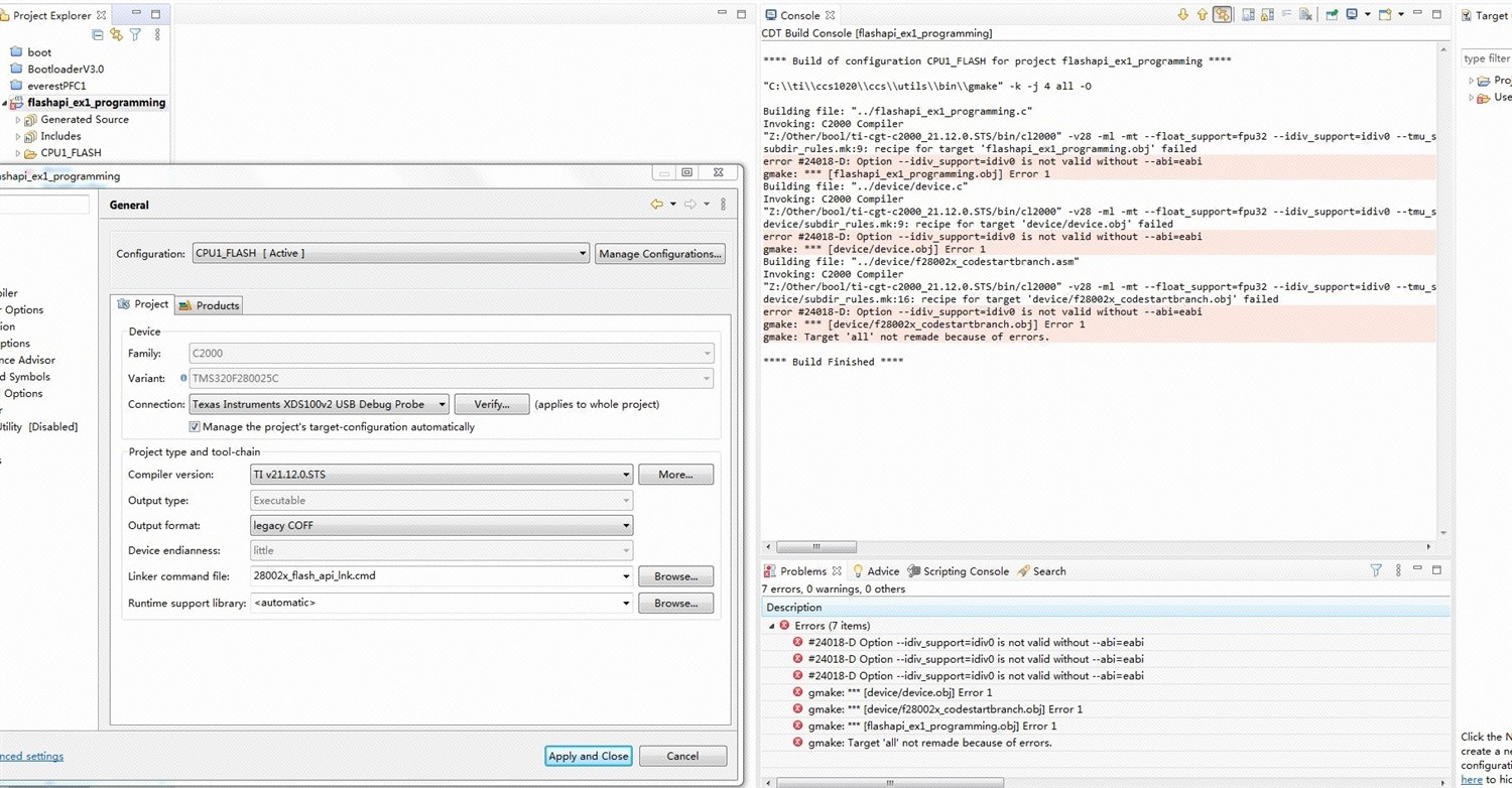

"../device/device.c", line 2: warning #1268-D: null (zero) character in input line ignored
"../device/device.c", line 2: error #7: unrecognized token
"../device/device.c", line 2: error #8: missing closing quote
"../device/device.c", line 3: warning #1-D: last line of file ends without a newline
"../device/device.c", line 3: error #7: unrecognized token
At end of source: warning #12-D: parsing restarts here after previous syntax error
22 errors detected in the compilation of "../device/device.c".
gmake: *** [device/device.obj] Error 1
Building file: "../device/f28002x_codestartbranch.asm"
"Z:/Other/bool/ti-cgt-c2000_21.12.0.STS/bin/cl2000" -v28 -ml -mt --float_support=fpu32 --idiv_support=idiv0 --tmu_support=tmu0 -Ooff --include_path="C:/Users/luoyz/workspace_v10/flashapi_ex1_programming" --include_path="C:/Users/luoyz/workspace_v10/flashapi_ex1_programming/device" --include_path="C:/ti/c2000/C2000Ware_4_00_00_00/driverlib/f28002x/driverlib" --include_path="C:/ti/c2000/C2000Ware_4_00_00_00/libraries/flash_api/f28002x/include/FlashAPI" --include_path="Z:/Other/bool/ti-cgt-c2000_21.12.0.STS/include" --define=CPU1 --define=_FLASH --diag_suppress=10063 --diag_warning=225 --diag_wrap=off --display_error_number --gen_func_subsections=on --abi=eabi --preproc_with_compile --preproc_dependency="device/f28002x_codestartbranch.d_raw" --include_path="C:/Users/luoyz/workspace_v10/flashapi_ex1_programming/CPU1_FLASH/syscfg" --obj_directory="device"  "../device/f28002x_codestartbranch.asm"
Finished building: "../device/f28002x_codestartbranch.asm"
gmake: Target 'all' not remade because of errors.
**** Build Finished ****
In General's Output format selection: legacy COFF), in processor Options, idiv select empty
"Z:/Other/bool/ti-cgt-c2000_21.12.0.STS/bin/cl2000" -v28 -ml -mt --float_support=fpu32 --tmu_support=tmu0 -Ooff --include_path="C:/Users/luoyz/workspace_v10/flashapi_ex1_programming" --include_path="C:/Users/luoyz/workspace_v10/flashapi_ex1_programming/device" --include_path="C:/ti/c2000/C2000Ware_4_00_00_00/driverlib/f28002x/driverlib" --include_path="C:/ti/c2000/C2000Ware_4_00_00_00/libraries/flash_api/f28002x/include/FlashAPI" --include_path="Z:/Other/bool/ti-cgt-c2000_21.12.0.STS/include" --define=CPU1 --define=_FLASH --diag_suppress=10063 --diag_warning=225 --diag_wrap=off --display_error_number --gen_func_subsections=on --abi=coffabi --preproc_with_compile --preproc_dependency="device/f28002x_codestartbranch.d_raw" --include_path="C:/Users/luoyz/workspace_v10/flashapi_ex1_programming/CPU1_FLASH/syscfg" --obj_directory="device"  "../device/f28002x_codestartbranch.asm"
Building file: "../device/device.c"
"Z:/Other/bool/ti-cgt-c2000_21.12.0.STS/bin/cl2000" -v28 -ml -mt --float_support=fpu32 --tmu_support=tmu0 -Ooff --include_path="C:/Users/luoyz/workspace_v10/flashapi_ex1_programming" --include_path="C:/Users/luoyz/workspace_v10/flashapi_ex1_programming/device" --include_path="C:/ti/c2000/C2000Ware_4_00_00_00/driverlib/f28002x/driverlib" --include_path="C:/ti/c2000/C2000Ware_4_00_00_00/libraries/flash_api/f28002x/include/FlashAPI" --include_path="Z:/Other/bool/ti-cgt-c2000_21.12.0.STS/include" --define=CPU1 --define=_FLASH --diag_suppress=10063 --diag_warning=225 --diag_wrap=off --display_error_number --gen_func_subsections=on --abi=coffabi --preproc_with_compile --preproc_dependency="device/device.d_raw" --include_path="C:/Users/luoyz/workspace_v10/flashapi_ex1_programming/CPU1_FLASH/syscfg" --obj_directory="device"  "../device/device.c"
Finished building: "../device/device.c"
"Z:/Other/bool/ti-cgt-c2000_21.12.0.STS/bin/cl2000" -v28 -ml -mt --float_support=fpu32 --tmu_support=tmu0 -Ooff --include_path="C:/Users/luoyz/workspace_v10/flashapi_ex1_programming" --include_path="C:/Users/luoyz/workspace_v10/flashapi_ex1_programming/device" --include_path="C:/ti/c2000/C2000Ware_4_00_00_00/driverlib/f28002x/driverlib" --include_path="C:/ti/c2000/C2000Ware_4_00_00_00/libraries/flash_api/f28002x/include/FlashAPI" --include_path="Z:/Other/bool/ti-cgt-c2000_21.12.0.STS/include" --define=CPU1 --define=_FLASH --diag_suppress=10063 --diag_warning=225 --diag_wrap=off --display_error_number --gen_func_subsections=on --abi=coffabi --preproc_with_compile --preproc_dependency="flashapi_ex1_programming.d_raw" --include_path="C:/Users/luoyz/workspace_v10/flashapi_ex1_programming/CPU1_FLASH/syscfg"  "../flashapi_ex1_programming.c"
Finished building: "../flashapi_ex1_programming.c"
Building target: "flashapi_ex1_programming.out"
Invoking: C2000 Linker
"Z:/Other/bool/ti-cgt-c2000_21.12.0.STS/bin/cl2000" -v28 -ml -mt --float_support=fpu32 --tmu_support=tmu0 -Ooff --define=CPU1 --define=_FLASH --diag_suppress=10063 --diag_warning=225 --diag_wrap=off --display_error_number --gen_func_subsections=on --abi=coffabi -z -m"flashapi_ex1_programming.map" --heap_size=0x100 --stack_size=0x200 --warn_sections -i"Z:/Other/bool/ti-cgt-c2000_21.12.0.STS/lib" -i"C:/ti/c2000/C2000Ware_4_00_00_00/libraries/flash_api/f28002x/lib" -i"Z:/Other/bool/ti-cgt-c2000_21.12.0.STS/include" --reread_libs --diag_wrap=off --display_error_number --xml_link_info="flashapi_ex1_programming_linkInfo.xml" --entry_point=code_start --rom_model -o "flashapi_ex1_programming.out" "./flashapi_ex1_programming.obj" "./device/device.obj" "./device/f28002x_codestartbranch.obj" "../28002x_flash_api_lnk.cmd" "../FlashAPI_F28002x_FPU32.lib" "C:/ti/c2000/C2000Ware_4_00_00_00/driverlib/f28002x/driverlib/ccs/Debug/driverlib.lib"  -llibc.a
<Linking>
warning #10373-D: library "C:/ti/c2000/C2000Ware_4_00_00_00/libraries/flash_api/f28002x/lib/FlashAPI_F28002x_FPU32.lib" contains ELF object files which are incompatible with the TI-COFF output file.  Ensure you are using the proper library.
warning #10373-D: library "../FlashAPI_F28002x_FPU32.lib" contains ELF object files which are incompatible with the TI-COFF output file.  Ensure you are using the proper library.
warning #10373-D: library "C:/ti/c2000/C2000Ware_4_00_00_00/driverlib/f28002x/driverlib/ccs/Debug/driverlib.lib" contains ELF object files which are incompatible with the TI-COFF output file.  Ensure you are using the proper library.
"../28002x_flash_api_lnk.cmd", line 71: warning #10068-D: no matching section
warning #10247-D: creating output section ".ebss" without a SECTIONS specification
 undefined                          first referenced
  symbol                                in file
 _Fapi_calculateEcc                 ./flashapi_ex1_programming.obj
 _Fapi_checkFsmForReady             ./flashapi_ex1_programming.obj
 _Fapi_doBlankCheck                 ./flashapi_ex1_programming.obj
 _Fapi_doVerify                     ./flashapi_ex1_programming.obj
 _Fapi_getFsmStatus                 ./flashapi_ex1_programming.obj
 _Fapi_initializeAPI                ./flashapi_ex1_programming.obj
 _Fapi_issueAsyncCommandWithAddress ./flashapi_ex1_programming.obj
 _Fapi_issueProgrammingCommand      ./flashapi_ex1_programming.obj
 _Fapi_setActiveFlashBank           ./flashapi_ex1_programming.obj
 _Flash_initModule                  ./flashapi_ex1_programming.obj
 _Interrupt_initModule              ./flashapi_ex1_programming.obj
 _Interrupt_initVectorTable         ./flashapi_ex1_programming.obj
 _RamfuncsLoadSize                  ./device/device.obj
 _RamfuncsLoadStart                 ./device/device.obj
 _RamfuncsRunStart                  ./device/device.obj
 _SysCtl_setClock                   ./device/device.obj
error #10234-D: unresolved symbols remain
error #10010: errors encountered during linking; "flashapi_ex1_programming.out" not built
>> Compilation failure
makefile:147: recipe for target 'flashapi_ex1_programming.out' failed
gmake[1]: *** [flashapi_ex1_programming.out] Error 1
makefile:143: recipe for target 'all' failed
gmake: *** [all] Error 2
So could you please kindly help analyze why the routine of F280025 in C2000ware will report an error when compiled in CCS? The customer has tried to reinstall CCS and C2000ware, but the problem has not been solved.
In addition, the customer will have the same problem when using other example projects of F28002x (using EABI). However, the project using F28004x/f2837x will not report an error. And customer's computer is encrypted. Hope this information is useful. Thanks!
