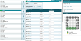

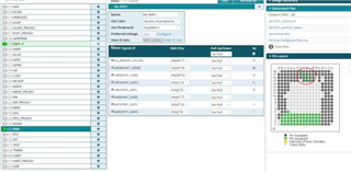

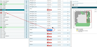

I refer to TRM manual 7.1.2
I have carried out pin configuration in TI PinMux Tool and found that the conditions cannot be met. It may be that some parts are not properly configured. I hope to obtain your technical support.
My configuration is as follows:
1. DDR3L
2. RMII1(100m Network)
3. LCD(RGB-480*800)
NorFlash(MT28EW256ABA)256Mbit, address line has 24, data line has 16 and control line, considering the sharing of data line + asynchronous or synchronous mode are not able to go on, occupy the LCD pin, do not know how to deal with, hope to get a help.
I have seen the design of tmdxice3359_sch_3h0013_v2_1a about NOR Flash (16 Mbit) on the official website, but it cannot meet the design of 256Mbit. Can you provide a reference design for designing NAND Flash&NOR Flash together? (or help to configure TI PinMux Tool, provide a reference).
Consultation the second option:
A. DDR3L (MT41K256M16HA-125)
B. RMII1(100 MBIT Network)
C. LCD(RGB-480*800)
D. NorFlash (MT28EW256ABA),256Mbit
E. eMMC (MTFC8GAMALBH), 8 gb

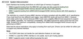

I noted in the TRM manual that MMC1 has a chance to be larger than 4Gb; The MMC0 limit is 4Gb.
Is it feasible? Reserve MMC1 channels for eMMC. Is there a reference design for that? (or provide a TI PinMux Tool configuration file)

  • Hello Gabriel Wang1,
    Let me check internally and comeback to you regarding the MMC memory size.
    Sreenivasa
    Can you please use the below link to generate the sysconfig file and share.
    https://dev.ti.com/sysconfig/#/start
    For the listed options looks like  using the 24 bit LCD is a major cause of conflict in addition to other issues including 2 MMC interfaces.
    Sreenivasa
    The below link could help in case you are looing to use MMC for boot.
    (+) AM3358: SD card boot from MMC1 - Processors forum - Processors - TI E2E support forums
    Sreenivasa
  • Dear Sreenivsa
    We need NandFlash(8Gb)+NorFlash (64MB)+ DDR3L solution, but must keep the LCD interface and RMII1. I have made it clear that MMC0 is not allowed to connect more than 4Gb. GPMC interfaces can share NOR+NAND, but we won't set it.
    Below is the configure file ,thanks!
