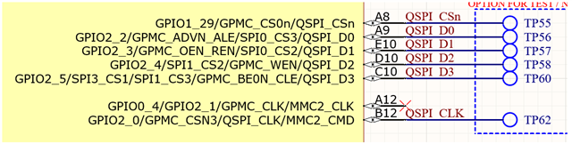

I would like to measure the frequency from XTAL 32768 (for RTC crystal) from AM4372 with PRCM block I would like to use mux and switch this signal for GPIO (like on picture below). How I can do this from PINMUX configuration?
SPRUHL7G–April 2014–Revised June 2017
For example I would like to switch this frequency signal from RTC with mux from PRCM into one of these GPIOs below, but how ?

  • This 32768 Hz clock from the oscillator can only be directly routed to the CLKOUT1 signal function which is only multiplexed to the "xdma_event_intr0" pin.
    For more information, refer to CLKOUT Signals section and the PRCM_CM_CLKOUT1_CTRL Register description in the device TRM.
