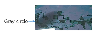

I am developing the new 8MP cis sensor device driver.
    DES (TI9702) - Ser(TI971) - 8MP Sensor ( 3840x2160, 4lane, MIPI datarate 900Mbps, RAW12  )
I check the I2C is working well. and I can observe the Sensor frame count is increasing.
But I can't captured data. saved image_0000.raw data is not normal.
This is related register situation

This is my log when I use run_app_single_cam.sh.
My sensor spec is similar with AR0820, so, I update the AR0820 code for the my sensor accordingly.
It seems sensor is providing the data. but TDA4 can't handle the this data properly.
Please check the my log. and give me the feedback.

  • Hi
    In the logs attached, I see that you are trying to configure Des UB960 and Ser UB953.
    Could you please clarify which Ser Des are you using? If not UB960, has the deserializer been integrated correctly?
    While the demo is running, could you press "p" and get the performance logs. Could you post the same?
    Nikhil
    Log is UB960, but this is actually 9702 Des.
    I just reuse and replace i2c command.
    My SerDes Setting is working on others platform.
    I think it seems DES-CSIRX is not connected properly.
    Below is log you asked me.

    2. Good board case, I can watch the image data. But, there is gray circle in the Image data. Gray circle is not provided from sensor.
    Plz check thease 2 issue.
    Could you dump the raw image from the camera? You could run the single cam demo and press "s" to dump the data.
    Could you share the dumps for camera output and VISS output?
    I think this should something related to the camera artifacts issue. Are you seeing the same in another sensor?
    Nikhil
  • Hello, Nikhil,
    Regarding the gary circle issue.
    I found Raw file is O.K, but yuv file only has the gray circle.
    unfortunately. I can't upload the related to file. due to company security issue.
    Can I give you file via mail?

  • Hi Lee,
    Thank you for sharing the images.
    May I know how you got the tuning parameters for your camera? Are you reusing the AR0820 camera's .bin files?
    If yes, I believe you would have to do the isp tuning for your camera and cannot use the AR0820 camera's .bin files.
    Could you please confirm this?
    Nikhil
  • I am using dcc_id = 9702.
    After I change the dcc id. gray circle was disappered.
    Thank you for checking.
