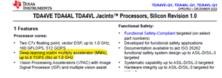

As ti.com has updated with TDA4VE-Q1 and variant devices, A customer begins to investigate this new deivce.
They found something to be clarified about Deep-learning Performance of those devices.
While We have promoted TDA4VE to the custoemr earlier, We said TDA4AL up to 8 TOPS, TDA4VL upto 4 TOPS, TDA4VE upto 8 TOPS according to below table.
Customer would like to get clarified the exact Deep-learning Performance of the respective devices to revise their business proposal to client.
Please answer to the question above regarding Deep-learning Performance.
Also make clarification on Datasheet too since many of customer would ask the same question to us in near future.

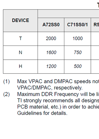

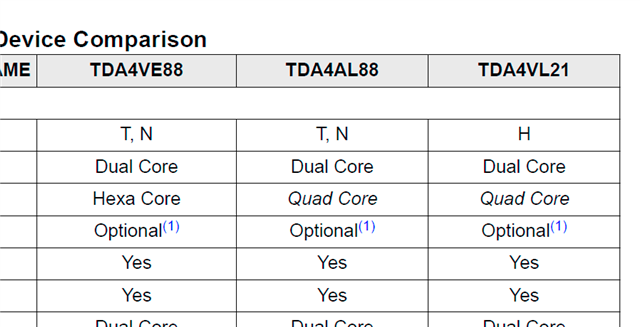

    The Deep Learning TOPS is dictated by the speed grade.  You can find which parts support which speed grade in the Device Comparison table:
    This table defines the C7x/MMA speed:
    The TOPS is equal to the C71SS speed multiplied by 8.  So, 1 GHz is 8 TOPS, 750 is 6 TOPS and 500 is 4 TOPS.
