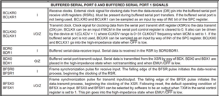

    Interfacing Serial port (TMS320C50) to Buffered serial port(TMS320VC549).
    Can you please confirm the above configuration and also pl suggest if there are any other concerns from your side regarding this implementation.
    Please refer the pinouts of Serial port interface.
    Please refer the pinouts of BSP.
  • Hello Sowmiya annamalai
    Thank you for the inputs.
    I would recommend you toi check the electrical compatibility.
    One of the device needs to be master that generates the clock.
    A termination on the clock inputs (serial termination) is recommended.
    Sreenivasa
