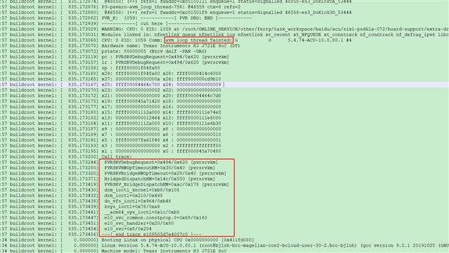

  • To add a question, there is a kernel dump problem today, which is also in the PVR content

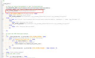

  • Hello Erick
    I have added running parameters in rc.pvr, as shown in the following figure
    because our underlying software will automatically load driver and start, and I will manually execute "/ rc.pvr stop ./ rc.pvr start" after the system starts, then run app
    Is this method effective ?
    This method is not effective at this point, we will need to ensure that the system does not load the GPU driver automatically. Is there any way to disable your system from loading the driver automatically? The blacklist steps I shared take care of default system initialization, but if you have something else in your system that does this it will be a problem.

  • Hello Li,
    After the analysis of the logs, I have the following comments:
    So, the second close() is actually closing a handle that GLES created after the first close. It is the application that could be corrupting the userspace GLES.
    Could you review the application please.
    Are you aware of this in your application? Please let me know.
    Erick
  • We suspect that the blocking of the glFinish for a few seconds is closely related to the current discussion of the coredump situation, as they almost appear together in the same version. Please also check this log.
    Perhaps these analysis findings can help with this issue as well. The "close()" function seems to be doing something strange in your application and it needs to be reviewed.

  • Li,
    It looks like from your logs that there is a glError reported with index 0x506:
    There is a framebuffer that is not complete, and this is what the initial analysis of the logs indicates as well. You can try checking the following function:
    https://registry.khronos.org/OpenGL-Refpages/es3.0/html/glCheckFramebufferStatus.xhtml
    This can give more insight to the framebuffer attachments. And we can see when the FRAMEBUFFER_COMPLETE is being returned, and when it suddenly changes to something else.
