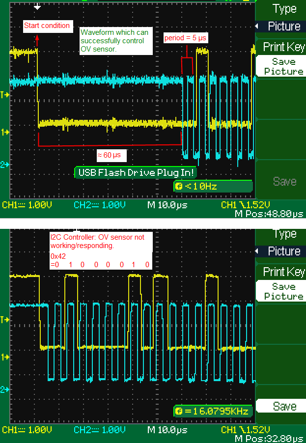

How to control the delay between START condition and the first word in an I2C controller’s write operation?
In the figure above, the upper part was the waveform captured by oscilloscope for a “driving board” that could successfully communicate with an OV sensor, and the below is the waveform when I am communicating with an OV sensor of the same type soldered on my customized board using DM6437’s I2C controller.
The most prominent difference is the delay time:
1.    In the “good" waveform, there is a 60 µs delay between the START condition and the slave address (0x42 for OV sensor).
2.    In DM6437’s I2C controller waveform, there is no such delay, and the START condition is immediately followed by the 0x42 device address.
The I2C clock speeds in both cases are 200K bits/s, which has been proven to be working by the “driving board”. It is also within the 100K (standard mode) – 400K (fast mode) bits/s range.
Since the “driving board” could make the sensor work (video can be seen), its waveform thus is guaranteed to be correct and I am attempting to mimic the waveform using DM6437’s I2C controller. So the problem is: How should I add the 60 µs delay between START condition and the slave address?
Does I2C controller allow such tuning? Could anyone help on this?

  • Hi Zheng,
    Unfortunately, the DM6437 I2C controller does not have such tuning capability.
    Have you tried to slow down the I2C clock some more to see if the OV sensor would respond?

    Tai,
    I have made the I2C clock very very slow to even 20 Kbits/s by changing the IPSC register, but of no avail.
    I have several further questions regarding your answer.
    1.    According to your knowledge, does the 60 µs delay exist in SCCB waveform? Is it necessary? Although I have captured this waveform on a driving device that is working properly, it is perhaps just one implementation that happened to work. I cannot rule out the possibility that some other problem caused my SCCB OV sensor not to respond. Could you consult TI employee with experience with SCCB on this?
    2.    I regard your answer as a confirmation that DM6437’s I2C controller cannot insert this arbitrary delay after the START condition. If not, and if such delay is necessary, this means DM6437’s I2C controller cannot be used to drive this particular SCCB device (there are many OV SCCB sensors and some are just more “I2C compatible” than others, according to MattLipsey). I therefore need another confirmation here: Are you aware of any instance that customers uses DM6437’s I2C controller to successfully communicate with an OV sensor, or not?
