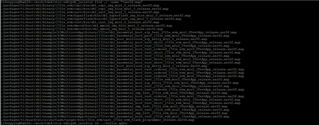

          1. Map file of MCU1_0 application and Linux/HLOS boot logs.
                         ----------------->the map file do you mean the file linker_mem_map? we didn't change the file.

    No not linker map file. I am asking for final built mem map file "xer5f.map".
    Tarun Mukesh
  • hi Tarun Mukesh
                 ----------> can you list the full name of the xer5f.map file or the path of the file ? thanks. (We are boot with SPL)
    After compilation you will have the executable in PDK_INSTALL_DIR/packages/ti/binary/<example> , in the same folder you will have mem map file.
    Tarun Mukesh
  • hi Tarun Mukesh
        From the path i didn't found the file
    For example we have it in
    ti-processor-sdk-rtos-j721e-evm-08_05_00_11/pdk_jacinto_08_05_00_36/packages/ti/binary/csl_mcan_evm_loopback_app/bin/j721e_evm/csl_mcan_evm_loopback_app_mcu1_0_release.xer5f.map
    The same executable file loaction from where you are flashing the SW and testing
    Tarun Mukesh
  • Our can module file path is as follows:rtos-sdk\vision_apps\platform\j721e\rtos\mcu1_0\can.  And this module has been compiled into Execution file of mcu1_0 . And where can i get the file? thanks.

    Can you search in the binary folder of vision apps with executable file name ".out.map" ?
