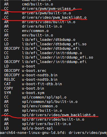

We want to display image through LCD in uboot (SDK9.0, uboot2023.04), enable CONFIG_DM_PWM and CONFIG_BACKLIGHT_PWM in the configuration to compile drivers/video/pwm_backlight.c, there is no problem compiling the file, but the following error is reported when linking spl/u-boot-spl:
OBJCOPY lib/efi_loader/initrddump.efi LD u-boot OBJCOPY u-boot.srec OBJCOPY u-boot-nodtb.bin RELOC u-boot-nodtb.bin CAT u-boot-fit-dtb.bin COPY u-boot.bin SYM u-boot.sym CC spl/common/spl/spl.o AR spl/common/spl/built-in.o CC spl/env/common.o AR spl/env/built-in.o LD spl/u-boot-spl aarch64-none-linux-gnu-ld.bfd: drivers/video/pwm_backlight.o: in function `set_pwm': /home/user/am62x/ti-u-boot/drivers/video/pwm_backlight.c:104: undefined reference to `pwm_set_config' /home/user/am62x/ti-u-boot/drivers/video/pwm_backlight.c:104:(.text.set_pwm+0x3c): relocation truncated to fit: R_AARCH64_CALL26 against undefined symbol `pwm_set_config' aarch64-none-linux-gnu-ld.bfd: /home/user/am62x/ti-u-boot/drivers/video/pwm_backlight.c:111: undefined reference to `pwm_set_invert' /home/user/am62x/ti-u-boot/drivers/video/pwm_backlight.c:111:(.text.set_pwm+0x50): relocation truncated to fit: R_AARCH64_CALL26 against undefined symbol `pwm_set_invert' aarch64-none-linux-gnu-ld.bfd: drivers/video/pwm_backlight.o: in function `pwm_backlight_enable': /home/user/am62x/ti-u-boot/drivers/video/pwm_backlight.c:161: undefined reference to `pwm_set_enable' /home/user/am62x/ti-u-boot/drivers/video/pwm_backlight.c:161:(.text.pwm_backlight_enable+0x40): relocation truncated to fit: R_AARCH64_CALL26 against undefined symbol `pwm_set_enable' /home/user/am62x/ti-u-boot/scripts/Makefile.spl:527: recipe for target 'spl/u-boot-spl' failed make[2]: *** [spl/u-boot-spl] Error 1 /home/user/am62x/ti-u-boot/Makefile:2043: recipe for target 'spl/u-boot-spl' failed make[1]: *** [spl/u-boot-spl] Error 2 make[1]: Leaving directory '/home/user/am62x/ti-u-boot/out/a53' Makefile:177: recipe for target 'sub-make' failed make: *** [sub-make] Error 2
The attachment is the configuration file of A53. Please help to confirm how to configure to use pwm-backlight?
