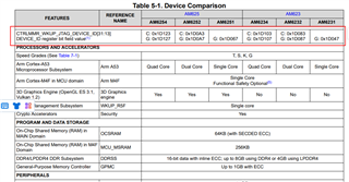

    What you can do, is to implement function ft_board_setup() in U-Boot board/am62x/evm.c to detect the device type, then disable the corresponding RTI watchdog or GPU device tree node.
    For detecting the device type, you can read the WKUP_CTRL_MMR_JTAG_USER_ID register (address 0x43000018), its device type bit value is documented at the top of Table 5-1 "Device Comparison" in AM62x Datasheet.

    I tried to find the register address for CTRLMMR_WKUP_JTAG_DEVICE_ID in the am625 chip manual and in the TRM, but only found the following address 0x43000014
    This reads out the following value:
    => md 0x43000014 1
    43000014: 0bb7e02f
    Is this the address, please?
  • Hi Toby,
    It appears both you and me are referring to an old version of the AM62x Datasheet, which has been updated on ti.com. The new version shows the register name is "MMR0_JTAG_USER_ID", which address is 0x43000018 - listed in Table 6-1303 in the AM62x TRM.
