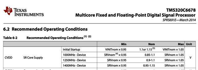

TMS320C6678: After power on, the CVDD is 1.13V, is it correct?
Part Number: TMS320C6678
Other Parts Discussed in Thread: UCD9222
Question 1: We have referenced EVM6678L to sample a new circuit board and downloaded the XML configuration of UCD9222 provided by EVM
After going to PMBus, I found that the CVDD is 1.13V and no software is running, which seems to be different from the configured 0.9V. Is it correct or does it need to be adjusted?
Question 2: Is there an update to the configuration or firmware of UCD9222 for C6678? Because TMDXEVM6678L_ UCD9222_ 16May11_ Ver5.xml cannot be used on the new Fusion Design Online, thank you!
