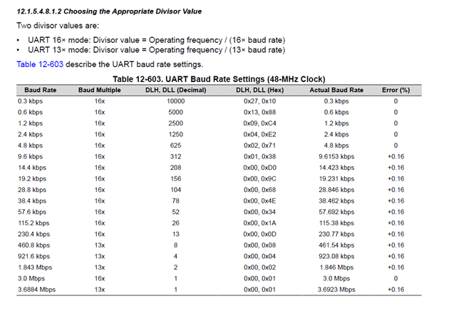

What does Operational mode mean in the attached and why is it related to the Baud Rate? Why only selectable 13x and 16x options? I can't find any information about this in the documentation.

Hello Bilal,
To answer your question, I have attached a snippet from the AM64x TRM.
Hope the above snippet helps.
Let me know in case you were looking for something else.
