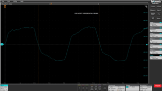

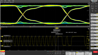

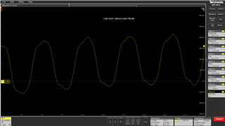

Hi
We are using AM625x in our design and we are performing DVT analysis of the USB interface on our board. We are observing the differential voltage exceeding 440mV. We are measuring 459.8 during write and 458.3mV during read which is slightly greater than the limit of 440mV. We are probing near the USB connector. Pls let us know if this is of any concern.
Prema
