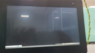

    On the other hand, the teared images are like that:
    it has a few lines of the camera

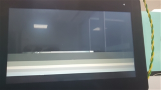

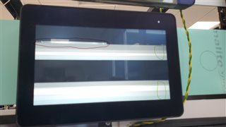

  • Hi Brijesh,
    I'm not sure if the white lines are part of the picture, sorry. Another pic.
    The red line is the part of the camera image. The green line points the white lines.
    Regarding if TV and LCD1 can be enabled simultaneously, we can have the two outputs working at the same time if there isn't camera.

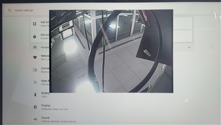

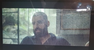

    I removed those patches, because, for now, we don't need the early boot, and configure correctly the overlays. Currently, we have the two display with the camera working, but, testing it, I found that if we play a video in the display with the camera overlay, the multimedia video and the camera mix together, both are working but mixed.
    Example with android settings UI and the camera working
    Example with a video and the camera mixed
    In the picture doesn't appreciate correctly, but the lines in the picture is the camera (working).
