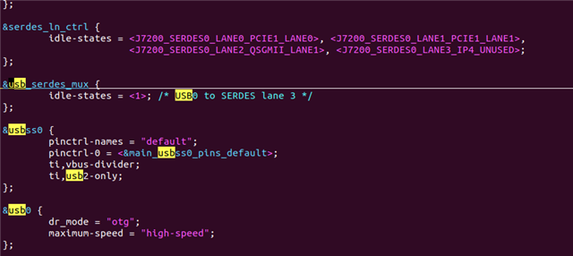

  • Hi Bo
    By default in DRA821(j7200) we not configuring the USB subsystem for USB3.0 you can take a reference from the j7200 dtsi
    ref:k3-j7200-common-proc-board.dts
    do let me know if you still face any issue.
    Diwakar

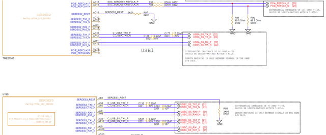

  • Diwakar,
    It turns out our host ports are indeed USB3 capable, so I guess serdes is needed. Here is a fragment of our schematic:
    The serdes3 connection is working fine. We can dfu properly through that usb port. The trouble I am having is with the top USB1 connection. It connects to the hub just as on BeagleBoneAI64.
    Can you confirm that our serdes2 settings look ok?
    /Bo

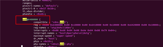

    so you mean for you USB 1 is not coming up in the UBOOT what is the dr_mode set there also please share the dtb by just doing a drag and drop  i will take a look at it.
    Diwakar
  • what is the dr_mode set there also please share the dtb by just doing a drag and drop  i will take a look at it.
    See first post. mode is set to "host".

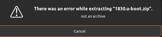

  • 1830.u-boot.zip
    I was able to upload if I changed the file type to .zip. Please just change it back to .dtb after download.
    /Bo
  • Hi Bo
    not able to extract

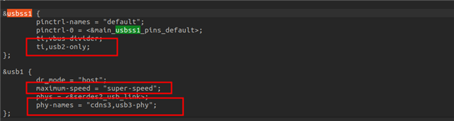

    &usbss1 {
        pinctrl-names = "default";
        pinctrl-0 = <&main_usbss1_pins_default>, <&mcu_usbss1_pins_default>;
        ti,vbus-divider;
        ti,usb2-only
    &usb1 {
        dr_mode = "host";
        maximum-speed = "high-speed";
    Diwakar

    Regarding the file, it is NOT a zip-file. Just rename the file from u-boot.zip to u-boot.dtb.

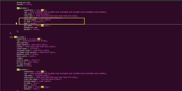

  • Hi Bo
    I have already tried those settings. They didn't help.
    What is the error you were getting with these changes ?
    why the mode is peripheral ?
    Diwakar
  • You are looking at the USBC port on usb0, which is working fine.
    Below, on address 0x6400000 you see usb1, which has dr_mode="host"
    /Bo
  • HI Bo
    if you see the logs its already working
    see the address usb@6400000  the controller is up and running
    i dont know what exactly you want to achieve here , my understanding  was you want both the usb subsystem USB0,USB1 to be  accessible in uboot.
    Diwakar

  • Another update:
    I can now get the host ports to work i u-boot by forcing them to USB2.0:
    &usbss1 {
        pinctrl-0 = <&main_usbss1_pins_default>;
        ti,vbus-divider;
        ti,usb2-only;
    This results in the following, in U-Boot:

  • Hi Diwakar,
    On the working USB2 USB1_DRVVBUS is working ok, and shows 3.3V.
    The current dts-tree looks like this now, usb0 is our USBC-port, used for dfu. usb1 is connected to the hub, just as on BeagleBone.
    &usb_serdes_mux {
    	idle-states = <1>, <1>; /* USB0 to SERDES3, USB1 to SERDES2 */
    &serdes_ln_ctrl {
    	idle-states = <J721E_SERDES0_LANE0_IP4_UNUSED>, <J721E_SERDES0_LANE1_IP4_UNUSED>,
    		      <J721E_SERDES1_LANE0_PCIE1_LANE0>, <J721E_SERDES1_LANE1_PCIE1_LANE1>,
    		      <J721E_SERDES2_LANE0_IP1_UNUSED>, <J721E_SERDES2_LANE1_USB3_1>,
    		      <J721E_SERDES3_LANE0_USB3_0_SWAP>, <J721E_SERDES3_LANE1_USB3_0>,
    		      <J721E_SERDES4_LANE0_IP2_UNUSED>, <J721E_SERDES4_LANE1_IP2_UNUSED>,
    		      <J721E_SERDES4_LANE2_IP2_UNUSED>, <J721E_SERDES4_LANE3_IP2_UNUSED>;
    &serdes_wiz3 {
    	typec-dir-gpios = <&main_gpio1 3 GPIO_ACTIVE_HIGH>;
    	typec-dir-debounce-ms = <700>;	/* TUSB321, tCCB_DEFAULT 133 ms */
    &serdes3 {
    	serdes3_usb_link: phy@0 {
    		reg = <0>;
    		cdns,num-lanes = <2>;
    		#phy-cells = <0>;
    		cdns,phy-type = <PHY_TYPE_USB3>;
    		resets = <&serdes_wiz3 1>, <&serdes_wiz3 2>;
    &usbss0 {
    	pinctrl-0 = <&main_usbss0_pins_default>;
    	ti,vbus-divider;
    &usb0 {
    	dr_mode = "peripheral";
    	maximum-speed = "super-speed";
    	phys = <&serdes3_usb_link>;
    	phy-names = "cdns3,usb3-phy";
    &serdes2 {
    	serdes2_usb_link: phy@1 {
    		reg = <1>;
    		cdns,num-lanes = <1>;
    		#phy-cells = <0>;
    		resets = <&serdes_wiz2 2>;
    &usbss1 {
    	ti,vbus-divider;
    	ti,usb2-only;
    &usb1 {
    	dr_mode = "host";
    	phys = <&serdes2_usb_link>;

  • Hi Bo
    can you add a print in the usb driver in linux so that at least will come to know why its is failing right now its bit difficult as we are not  getting any print in the linux.
    share final dtb which you are corrently using  config file also can you dump these register
    0x104080
