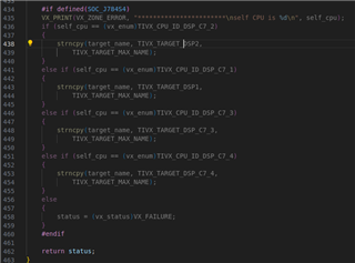

We are currently working on building a custom Object detection application that would work on different C7 cores. On going through the existing code present in SDK we realized that the c7 cores used for Pre-processing and Post-processing nodes are mapped to C7_2 only. Is there a specific reason for using only C7_2 for this? We figured this out from the macros provided in tivx_soc_j784s4.h where
TIVX_CPU_ID_DSP1 = TIVX_CPU_ID_DSP_C7_2
and
TIVX_TARGET_DSP1 = TIVX_TARGET_DSP_C7_2
We tried to update these macros to map DSP1 to C7_1 and vice versa and updated the make-file for the respective C7 cores as well, but found out that the pre-processing step is failing in other cores except when it is running in C7_2 core. Could you suggest on how can we implement these nodes (Pre-processing and post-processing) on different cores.

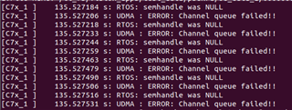

The error I am getting while running the nodes in C7_1 node is:

  • Hi Srikar,
    Could you let me know if you are seeing the same issue when you are running it on C7_3 and C7_4?
    Nikhil
  • Hi Nikhil,
    This issue is currently occuring only in C7x_1 core. I tried with 3 and 4 but they seem to work fine.
    I made the following changes in the code:
    /home/svaraganti/ti-processor-sdk-rtos-j784s4-evm-09_00_00_02/vision_apps/platform/j784s4/rtos/common/app_init.c
    /home/svaraganti/ti-processor-sdk-rtos-j784s4-evm-09_00_00_02/vision_apps/platform/j784s4/rtos/c7x_1/concerto_c7x_1_inc.mak
    /home/svaraganti/ti-processor-sdk-rtos-j784s4-evm-09_00_00_02/tiovx/kernels/common/host/tivx_kernels_host_utils.c
    /home/svaraganti/ti-processor-sdk-rtos-j784s4-evm-09_00_00_02/tiovx/kernels/common/target/tivx_kernels_target_utils.c

  • Yes, As expected, the kernels of preproc and post procs are only present in C7x 2,3 and 4.
    Could you add them in 1 and test again?
    i.e. in concerto_c7x_2_inc.mak, you could find below
    STATIC_LIBS += vx_target_kernels_srv_c66
    STATIC_LIBS += vx_target_kernels_img_proc_c66
    STATIC_LIBS += vx_target_kernels_stereo
    This is also seen in c7x_3 and c7x_4_inc.mak... Could you add this in c7x_1_inc.mak in ${PSDKRA}/vision_apps/platform/j784s4/rtos/c7x_1/concerto_c7x_1_inc.mak
    Nikhil
  • Hi Nikhil,
    I forgot to include this in previous response, we have added these lines in C7x_1_inc.mak as well.
    I believe your TIDL node is also running on C7x_1 right? Could you try by moving it to different core? Do you still see this error?
    Could you share the full logs in a .txt file (along with the remote core logs, i.e. run ./vision_apps_init.sh before running your demo)
    Nikhil
  • The goal is to run all the nodes in a app in single node. Furthermore, for the other apps running on C7x_2/3/4 tidl node is operating in the respective core itself and there is no issue with object detection with that app.
    I tried running the app with TIDL node in a different core(C7X_2 and other nodes in C7x_1) still the issue is persistent and same.
    I am trying to add the .txt files for log but not able to upload them here. Can you send me a link or suggest another way to send these files to you.
    oh..ok.. So all nodes including TIDL on C7x_2 /3/4 works fine, but all the nodes of C7x_1 including TIDL does not work fine.. Is my understanding of your issue correct?

    [C7x_1 ]    223.194448 s: RTOS: semhandle was NULL
    [C7x_1 ]    223.194469 s: UDMA : ERROR: Channel queue failed!!
    [C7x_1 ]    223.194481 s: RTOS: semhandle was NULL
    [C7x_1 ]    223.194496 s: UDMA : ERROR: Channel queue failed!!
    [C7x_1 ]    223.194507 s: RTOS: semhandle was NULL
    [C7x_1 ]    223.194522 s: UDMA : ERROR: Channel queue failed!!
    [C7x_1 ]    223.194725 s: RTOS: semhandle was NULL
    [C7x_1 ]    223.194741 s: UDMA : ERROR: Channel queue failed!!
    [C7x_1 ]    223.194752 s: RTOS: semhandle was NULL
    [C7x_1 ]    223.194771 s: UDMA : ERROR: Channel queue failed!!
    [C7x_1 ]    223.194782 s: RTOS: semhandle was NULL
    [C7x_1 ]    223.194797 s: UDMA : ERROR: Channel queue failed!!

    [C7x_1 ]    223.588051 s: RTOS: semhandle was NULL
    [C7x_1 ]    223.588072 s: UDMA : ERROR: Channel queue failed!!
    [C7x_1 ]    223.588084 s: RTOS: semhandle was NULL
    [C7x_1 ]    223.588099 s: UDMA : ERROR: Channel queue failed!!
    [C7x_1 ]    223.588110 s: RTOS: semhandle was NULL
    [C7x_1 ]    223.588125 s: UDMA : ERROR: Channel queue failed!!
    [C7x_1 ]    223.588330 s: RTOS: semhandle was NULL
    [C7x_1 ]    223.588346 s: UDMA : ERROR: Channel queue failed!!
    [C7x_1 ]    223.588357 s: RTOS: semhandle was NULL
    [C7x_1 ]    223.588372 s: UDMA : ERROR: Channel queue failed!!
    [C7x_1 ]    223.588383 s: RTOS: semhandle was NULL
    [C7x_1 ]    223.588398 s: UDMA : ERROR: Channel queue failed!!

    [C7x_1 ]    223.999506 s: RTOS: semhandle was NULL
    [C7x_1 ]    223.999526 s: UDMA : ERROR: Channel queue failed!!
    [C7x_1 ]    223.999539 s: RTOS: semhandle was NULL
    [C7x_1 ]    223.999554 s: UDMA : ERROR: Channel queue failed!!
    [C7x_1 ]    223.999565 s: RTOS: semhandle was NULL
    [C7x_1 ]    223.999580 s: UDMA : ERROR: Channel queue failed!!
    [C7x_1 ]    223.999786 s: RTOS: semhandle was NULL
    [C7x_1 ]    223.999802 s: UDMA : ERROR: Channel queue failed!!
    [C7x_1 ]    223.999814 s: RTOS: semhandle was NULL
    [C7x_1 ]    223.999829 s: UDMA : ERROR: Channel queue failed!!
    [C7x_1 ]    223.999840 s: RTOS: semhandle was NULL
    [C7x_1 ]    223.999855 s: UDMA : ERROR: Channel queue failed!!

    [C7x_1 ]    224.394877 s: RTOS: semhandle was NULL
    [C7x_1 ]    224.394898 s: UDMA : ERROR: Channel queue failed!!
    [C7x_1 ]    224.394910 s: RTOS: semhandle was NULL
    [C7x_1 ]    224.394925 s: UDMA : ERROR: Channel queue failed!!
    [C7x_1 ]    224.394936 s: RTOS: semhandle was NULL
    [C7x_1 ]    224.394951 s: UDMA : ERROR: Channel queue failed!!
    [C7x_1 ]    224.395153 s: RTOS: semhandle was NULL
    [C7x_1 ]    224.395169 s: UDMA : ERROR: Channel queue failed!!
    [C7x_1 ]    224.395181 s: RTOS: semhandle was NULL
    [C7x_1 ]    224.395196 s: UDMA : ERROR: Channel queue failed!!
    [C7x_1 ]    224.395206 s: RTOS: semhandle was NULL
    [C7x_1 ]    224.395221 s: UDMA : ERROR: Channel queue failed!!

    [C7x_1 ]    224.790165 s: RTOS: semhandle was NULL
    [C7x_1 ]    224.790187 s: UDMA : ERROR: Channel queue failed!!
    [C7x_1 ]    224.790199 s: RTOS: semhandle was NULL
    [C7x_1 ]    224.790215 s: UDMA : ERROR: Channel queue failed!!
    [C7x_1 ]    224.790226 s: RTOS: semhandle was NULL
    [C7x_1 ]    224.790241 s: UDMA : ERROR: Channel queue failed!!
    [C7x_1 ]    224.790443 s: RTOS: semhandle was NULL
    [C7x_1 ]    224.790459 s: UDMA : ERROR: Channel queue failed!!
    [C7x_1 ]    224.790470 s: RTOS: semhandle was NULL
    [C7x_1 ]    224.790489 s: UDMA : ERROR: Channel queue failed!!
    [C7x_1 ]    224.790499 s: RTOS: semhandle was NULL
    [C7x_1 ]    224.790514 s: UDMA : ERROR: Channel queue failed!!

    [C7x_1 ]    225.199412 s: RTOS: semhandle was NULL
    [C7x_1 ]    225.199433 s: UDMA : ERROR: Channel queue failed!!
    [C7x_1 ]    225.199445 s: RTOS: semhandle was NULL
    [C7x_1 ]    225.199461 s: UDMA : ERROR: Channel queue failed!!
    [C7x_1 ]    225.199472 s: RTOS: semhandle was NULL
    [C7x_1 ]    225.199486 s: UDMA : ERROR: Channel queue failed!!
    [C7x_1 ]    225.199689 s: RTOS: semhandle was NULL
    [C7x_1 ]    225.199705 s: UDMA : ERROR: Channel queue failed!!
    [C7x_1 ]    225.199717 s: RTOS: semhandle was NULL
    [C7x_1 ]    225.199732 s: UDMA : ERROR: Channel queue failed!!
    [C7x_1 ]    225.199742 s: RTOS: semhandle was NULL
    [C7x_1 ]    225.199757 s: UDMA : ERROR: Channel queue failed!!

    [C7x_1 ]    225.595273 s: RTOS: semhandle was NULL
    [C7x_1 ]    225.595295 s: UDMA : ERROR: Channel queue failed!!
    [C7x_1 ]    225.595307 s: RTOS: semhandle was NULL
    [C7x_1 ]    225.595322 s: UDMA : ERROR: Channel queue failed!!
    [C7x_1 ]    225.595333 s: RTOS: semhandle was NULL
    [C7x_1 ]    225.595348 s: UDMA : ERROR: Channel queue failed!!
    [C7x_1 ]    225.595552 s: RTOS: semhandle was NULL
    [C7x_1 ]    225.595568 s: UDMA : ERROR: Channel queue failed!!
    [C7x_1 ]    225.595579 s: RTOS: semhandle was NULL
    [C7x_1 ]    225.595594 s: UDMA : ERROR: Channel queue failed!!
    [C7x_1 ]    225.595604 s: RTOS: semhandle was NULL
    [C7x_1 ]    225.595619 s: UDMA : ERROR: Channel queue failed!!

    [C7x_1 ]    225.992702 s: RTOS: semhandle was NULL
    [C7x_1 ]    225.992723 s: UDMA : ERROR: Channel queue failed!!
    [C7x_1 ]    225.992737 s: RTOS: semhandle was NULL
    [C7x_1 ]    225.992752 s: UDMA : ERROR: Channel queue failed!!
    [C7x_1 ]    225.992763 s: RTOS: semhandle was NULL
    [C7x_1 ]    225.992782 s: UDMA : ERROR: Channel queue failed!!
       225.996752 s:  VX_ZONE_INFO:[ownCheckGraphCompleted:695] Graph Completed (graph=209, pipe=2)
       225.996781 s:  VX_ZONE_INFO:[ownCheckGraphCompleted:720] All Graphs Completed
    [C7x_1 ]    225.992985 s: RTOS: semhandle was NULL
    [C7x_1 ]    225.993002 s: UDMA : ERROR: Channel queue failed!!
    [C7x_1 ]    225.993013 s: RTOS: semhandle was NULL
    [C7x_1 ]    225.993028 s: UDMA : ERROR: Channel queue failed!!
    [C7x_1 ]    225.993038 s: RTOS: semhandle was NULL
    [C7x_1 ]    225.993053 s: UDMA : ERROR: Channel queue failed!!

    [C7x_1 ]    227.225133 s: RTOS: semhandle was NULL
    [C7x_1 ]    227.225153 s: UDMA : ERROR: Channel queue failed!!
    [C7x_1 ]    227.225166 s: RTOS: semhandle was NULL
    [C7x_1 ]    227.225181 s: UDMA : ERROR: Channel queue failed!!
    [C7x_1 ]    227.225192 s: RTOS: semhandle was NULL
    [C7x_1 ]    227.225207 s: UDMA : ERROR: Channel queue failed!!
    [C7x_1 ]    227.225409 s: RTOS: semhandle was NULL
    [C7x_1 ]    227.225426 s: UDMA : ERROR: Channel queue failed!!
    [C7x_1 ]    227.225437 s: RTOS: semhandle was NULL
    [C7x_1 ]    227.225452 s: UDMA : ERROR: Channel queue failed!!
    [C7x_1 ]    227.225463
    1.
    [C7x_1 ]    227.225477 s: UDMA : ERROR: Channel queue failed!!

    [C7x_1 ]    227.619185 s: RTOS: semhandle was NULL
    [C7x_1 ]    227.619206 s: UDMA : ERROR: Channel queue failed!!
    [C7x_1 ]    227.619219 s: RTOS: semhandle was NULL
    [C7x_1 ]    227.619235 s: UDMA : ERROR: Channel queue failed!!
    [C7x_1 ]    227.619246 s: RTOS: semhandle was NULL
    [C7x_1 ]    227.619261 s: UDMA : ERROR: Channel queue failed!!
    [C7x_1 ]    227.619463 s: RTOS: semhandle was NULL
    [C7x_1 ]    227.619479 s: UDMA : ERROR: Channel queue failed!!
    [C7x_1 ]    227.619490 s: RTOS: semhandle was NULL
    [C7x_1 ]    227.619505 s: UDMA : ERROR: Channel queue failed!!
    [C7x_1 ]    227.619516 s: RTOS: semhandle was NULL
       227.630070 s:  VX_ZONE_INFO:[ownCheckGraphCompleted:695] Graph Completed (graph=208, pipe=1)
    [C7x_1 ]    227.619531 s: UDMA : ERROR: Channel queue failed!!

    I'm suspecting the cause of this issue to be because of #undef ENABLE_UDMA_COPY in vision_apps/platform/j784s4/rtos/common/app_cfg_c7x_1.h
    Let me check internally why this is disabled only on C7x_1..
    Meanwhile, could you enable this and check if this works for you?
    Nikhil
  • Yes Nikhil,
    This change within app_cfg_c7x_1.h worked, Now i am able to run the application without the error. Please let me know once you have discussion with your team on why was this disabled initially.

  • Hi Srikar,
    This was disabled because this UDMA copy channel create was used mostly by the pre-proc and post-proc nodes on C7x_2, 3, 4.
    Hence, it was disabled on C7x_1.
