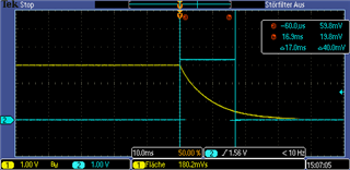

Hey all,
at the moment I'm working with a TI CC1310 and the Sensor Controller Studio.

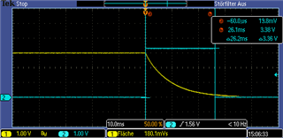

I'm trying to measure the time of decharging a capacitor with a series resistor from 3.0V to 0.825V.
For that I'm using the COMPB-module which should fire an event, if the voltage level on the capacitor (PIN_COMP) falls below 0.825V (COMPB_REF_VDDS_DIV4).

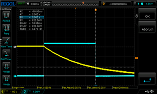

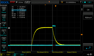

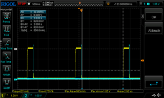

To visualize the moment of the event as accurate as possible, I set a digital output pin (PIN_TRIGGERED) to high if I start decharging and to low if the event occurs.
I expect that the time in which PIN_TRIGGERED is high should always be on the same time, because its always the same resistor and the same capacitor, but the event occurs on different times.
It looks like the event is not triggered through falling below the 0,825V level.
What did I do wrong?
Manuel
