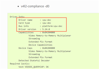

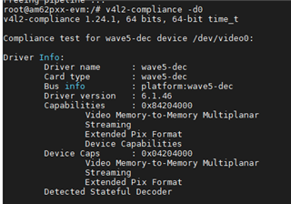

I'm testing the video codec of the VPU.There are many differents in AM62P Yocto SDK user manual.3.9Multimedia Video Codec
I use command "v4l2-compliance -d0“

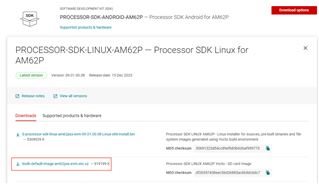

    https://dr-download.ti.com/software-development/software-development-kit-sdk/MD-9ti3Ig9hNi/09.01.00.08/tisdk-default-image-am62pxx-evm.wic.xz
    Follow the instructions provided here:
    https://software-dl.ti.com/processor-sdk-linux/esd/AM62PX/09_01_00_08/exports/docs/linux/Overview/Processor_SDK_Linux_create_SD_card.html#create-sd-card-using-balenaetcher
