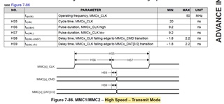

Hi, Dear Expert

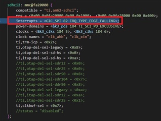

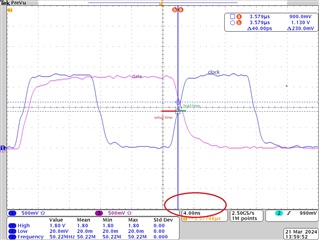

I try to adjust SDIO CLK/DATA "setup time" and "hold time" in "high speed mode", even we know data sheet has recommend value, but it's insufficient in data "hold time".

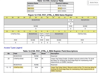

I think the only way is try to adjust "MMCSD0_SS_PHY_CTRL_4_REG" and "MMCSD0_SS_PHY_CTRL_5_REG"
Q1 : What's delay unit for OTAPDLYSEL in MMCSD0_SS_PHY_CTRL_4_REG? (ns? ps?)

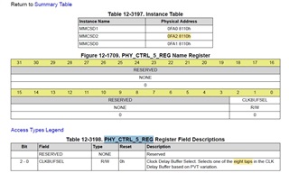

Q2 : What is CLKBUFSEL in PHY_CTRL_5_REG?
I am not sure what's the meaning for 0x07 (CLKBUFSEL)
