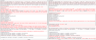

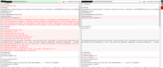

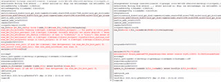

  • No worries.
    Same problem when using `configs/processor-sdk-linux/processor-sdk-linux-09_02_00_05.txt`.
    Just to give you some hint: I mounted the SD card rootfs, and manually copied `<rootfs>/boot/dtb/*dtb*` to `<rootfs>/boot/`, then the kernel boots.
    Something changed in your u-boot env/script?
    BR/Chencheng

  • Chencheng,
    I am not sure how much help we can be here since we are unable to re-create your problem. There are many differences in the environments that we see in our builds. I am not sure why yours is not getting this set up.
    Our file is on the right and yours is on the left.
    One of our Yocto experts did not see anythig modifying the environment in meta ti, or meta arago.
    -josue
