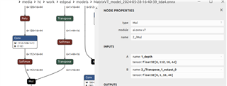

my sdk version is 9.2.7, it does not has this error, Perhaps my script got stuck before reaching this step of reducemean.
this is the model of the node reducemean with 1 batch.1_batch.rar
Thanks! I will try it.
Hi Pratik,
I tried it on 9.2.7 and it still stuck .
python3 multi_input_no_post.py -c -m motorvis_matrix
Available execution providers : ['TIDLExecutionProvider', 'TIDLCompilationProvider', 'CPUExecutionProvider']

Thanks for observations adam, from the logs seems like its stuck due to thread wait.
Can you set uncomment below line and try it again ?
Hi Pratik,
cpu number has been already set to 1 since I only run one model. The process still stuck and the log is exactly the same.
Hi Pratik,
I tried 32bit and it stuck at the same place, the log is exactly the same. This models runs successfully on onnx rt.
Hi han,
Please change this node. The mul layer is not supported. Mul should either be the same dimension for two inputs or should be 1x1 in HxW for one input and other dimension values the same for two inputs.
Adam
Hi Han,
And please add this advanced options of c7x firmware version to enable broadcast Mul:
Adam
I have added the options, but the state is same with before. and this is the model of same shape between 1_depth and 2_/Transpose_1_output_0.MatrixVT_model_2024-06-11-14-43-42_tda4.rar
Hi Han,
Thanks for your quick input. The process ends with "ERROR: Batch processing is not supported for this TIDL_ReduceMeanLayer, so exiting from import " on my side. This log comes from that the input tensors of the model indicates that batch processing is used. AM68a does not support batch processing at all so the batch dimension of all inputs should be 1.
Adam
this is the model of input with 1, 18,256,704 tensor shape.MatrixVT_model_2024-06-12-11-40-51_tda4.rar
Hi Han,
The model can pass the first few operations in import now but still got some error. We will look into this further.
python3 multi_input_no_post.py -c -m matrix
