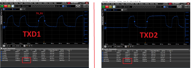

We Isolated RGMII TX_D1 & TX_D2 between the EPHY & AM6422 by removing the series resistor and loaded them with AM6422 pin capacitance + trace capacitance + external 5pF capacitor, we do not observe significant difference in TX_D1 & TX_D2 rise/fall time, it was close to the 0.75ns as expected.
However, if EPHY (DP83867IRRGZ) is connected with AM6422 at that time around 1.2ns rise & fall time obseved for TX_D0 & TX_D1 signal. This is weird, Seems loding on TX_D0 & TX_D1 pin of DP83867IRRGZ is higher than 5pF.
While capturing the RGMII signal of all 3-interface channels. We observed around 1.2ns rise & fall time for TX_D0 & TX_D1 signal, which is violating the rise & fall time limit. TX_CLK, TX_D2 & TX_D3 signal rise & fall time is closer the 0.75nS and better then TX_D0 & TX_D1.
To double confirm the observation, We swaped the TX_D1 & TX_D2 connection ( Connected TX_D1 pin of SOC with TX_D2 pin of EPHY & Connected TX_D2 pin of SOC with TX_D1 pin of EPHY) and observed acceptable rise/fall (~0.75) time on TX_D2 pin of EPHY, However higher rise/fall (~1.2) time on TX_D1 pin of EPHY.
We believe loading on the TX_D0 & TX_D1 signal is higher then other TX_CLK, TX_D2 & TX_D3 signal.

We have observed significant difference in rise/fall time of TX_D0 & TX_D1 compared to TX_CLK, TX_D2 & TX_D3. we recommend to check rise/fall time at TI end and confirm rise/fall time of TX_D0 & TX_D1 is above 0.75nS or not? if rise/fall time of TX_D0 & TX_D1 is above then what are the solution available with TI.

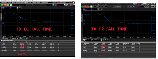

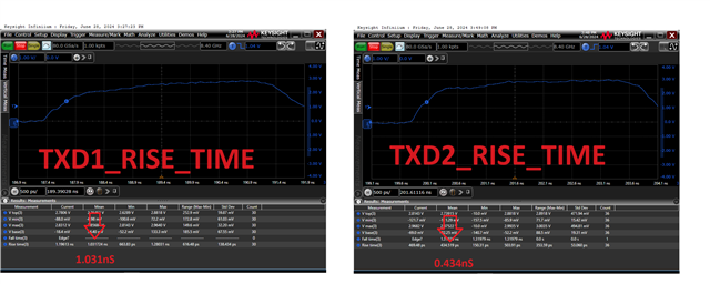

Below requested waveform clearly represent that loading on the TX_D1 is more compared to other (TX_D2) signal. Common test method is used for the same.
--> Below is the rise/fall time waveforms of TX_D1_5ns_H_Scale.zip & TX_D2_5ns_H_Scale.zip at 5nS Horizontal scale.
--> Below is the rise time waveform for TX_D1_0.5ns_Rise.zip & TX_D2_0.5ns_rise.zip at 0.5nS horizontal scale.
--> Below is the falltime waveform for TX_D1_0.5ns_fall.zip & TX_D2_0.5ns_fall.zip at 0.5nS horizontal scale.
At 0.5nS horizontal scale rise time & fall time of TX_D1 is ~1nS, which is violating the 0.75nS limit.

Just for your information rise/fall time is based on 20% to 80% (not 10% to 90%).

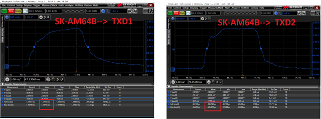

Just for your reference, We have observed similar(less) rise/fall time on TX_D0 & TX_D1 in the TI EVM kit # SK-AM64B. if you want to see at your (TI) side then you can check.
Vaibhav
Dear Sreenivasa,
We have also checked the rise/fall time of TX_Data signals in the TI EVM kit # SK-AM62A-LP and observed less rise/fall time on TX_D0 & TX_D1. you can also double confirm same issue in TI EVM kit # SK-AM62A-LP.
