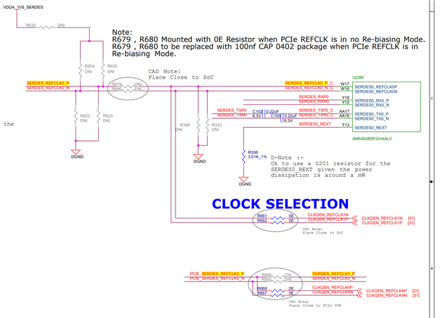

I found in AM64 evm schematic, there is a description about PCIE clk.
I want to know what is meaning of re-biasing mode?
Currently the SOC and the external connector is being clocked by CDCI6214RGET
Alternatively PCIe clock from the SOC could be configured as the REFCLK or External clock can connected to the SOC
When the clocks are compatible HCSL the below is the recommended changes
R679 , R680 Mounted with 0E Resistor when PCIe REFCLK is in no Re-biasing Mode.
R665, R666 mounted
R667, R668 DNI
When the clocks are not compatible HCSL - LVDS ( interface an LVDS output with an HSCL-compliant input) the below is the recommended changes
R679 , R680 to be replaced with 100nf CAP 0402 package when PCIe REFCLK is in
Re-biasing Mode.
R665, R666 mounted
R667, R668 DNI

Just to add to Sreenivasa's comment:
The EVM was designed to support multiple SERDES clocking configurations, hence the need for different BOM stuff options.
SERDES0 REFCLKP/N requires HCSL-level inputs when operating in input mode.
In the default (shipped) state, PCIe REFCLK is supplied to both the SoC and the PCIe connector via the CDCI6214 clock generator device operating in HCSL mode. For TMDS64GPEVM Revision PROC101B(001) you will find the required on-board 49.9 (1%) Ohm termination resistors for same installed as R681/R682 and R683/R684 respectively.
