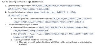

    I have a follow up questions. I ran the following commands (in order) before compiling the code:
    gen_keywr_cert.sh -g
    gen_keywr_cert.sh --msv 0xC0FFE -t tifek/ti_fek_public.pem
    cd ../../x509cert && python3 ../../../../../tools/bin2c/bin2c.py final_certificate.bin keycert.h KEYCERT
    Also, I ran:
    gen_keywr_cert.sh -t tifek/ti_fek_public.pem --msv 0xC0FFE -b keys_devel/bmpk.pem --bmek keys_devel/bmek.key -s keys_devel/smpk.pem --smek keys_devel/smek.key --keycnt 1 --keyrev 1
    As you noticed the gen_keywr_cert.sh parameters --keycnt and --keyrev was 1. After executing the said command, I compiled the code.

    In the AM62X_OTP_Keywriter_User_Guide
    • Each command in the table below results in a fresh boot of the device.
    • In other words, with each command we program certain fields, build a new keywriter app
    with a new certificate, and reboot the device.
    • Until the KEYREV value is set to either 1 or 2, the device is considered an HS-FS device, and key
    values can continue being programmed incrementally.
    • This allows key programming to be done in multiple passes.
    • However, once the KEYREV value is set to 1 or 2, the device becomes an HS-SE device, and the OTP
    keywriter application will no longer boot since the user root key has now taken over as the root of
    trust.
    • So, programming the KEYREV should be left to the final step.
    Also, 3.2.2:
    "After a reboot or a power on reset, the device will become an HS-SE device and enforce secure
    booting."
    3.2.2 Program Everything in One Shot
    ./gen_keywr_cert.sh -t tifek/ti_fek_public.pem --msv 0xC0FFE -b keys_devel/bmpk.pem
    2 --keyrev 1
    • Above is the example command given for programming multiple fields at once (in one boot).
    • The resulting certificate given will program the MSV, SMPK, SMEK, BMPK, BMEK, key count, and key
    revision all at once.
    • After a reboot or a power on reset, the device will become an HS-SE device and enforce secure
    booting.
    • One thing to keep in mind for this method is that the certificate should be less than 5400 bytes.
    • If the certificate does not fit within 5400 bytes, use the incremental method instead.
    • Additionally, if the extended OTP needs to be programmed via keywriter (for USB/PCIE VID/PID), make sure
    to program the extended OTP before converting the device to an HS-SE device.
    I want to set the device as HS-SE so meaning, I have to set the KEYREV to 2 or 1. Could you tell me what am I missing?
    John
    Please build the keywriter binary with the certificate generated by the command mentioned in the section "3.2.2 Program Everything in One Shot" for converting HSFS to HSSE.
    Prashant
