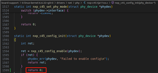

I am using TJA110 C45  on AM62A7 ,the driver is
board-support/ti-linux-kernel-6.6.32+git-ti/drivers/net/phy/nxp-c45-tja11xx.c
Encountered the following issue:
Environment:
ti-processor-sdk-linux-edgeai-am62a-evm-10_00_00_08
Device Tree
&cpsw3g_mdio {
        status = "okay";
        pinctrl-names = "default";
        pinctrl-0 = <&main_mdio1_pins_default>;
        cpsw3g_phy1: ethernet-phy@1 {
                compatible = "ethernet-phy-ieee802.3-c45";
                reg = <1>;
                //ti,rx-internal-delay = <DP83867_RGMIIDCTL_2_00_NS>;
                //ti,fifo-depth = <DP83867_PHYCR_FIFO_DEPTH_4_B_NIB>;
                ti,min-output-impedance;
Error
get_phy_device
  • get_phy_c45_ids
    • get_phy_c45_devs_in_pkg
      • mdiobus_c45_read // returns -22
How should I resolve this issue?

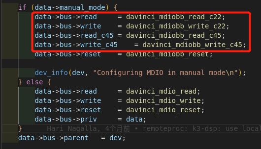

    First, I took a look at the get_phy_c45_devs_ids function (drivers/net/phy/phy_device.c) and it seems that the only expected return values are 0, -EIO (-5), or -ENODEV (-19). A return value of -22 (-EINVAL) would indicate some sort of invalid argument. https://elixir.bootlin.com/linux/v6.12.4/source/include/uapi/asm-generic/errno-base.h
    On AM62Ax devices, the ethernet driver should be am65-cpsw-nuss.c and the mdio driver is davinci_mdio.c. Within davinci_mdio.c (drivers/net/ethernet/ti/davinci_mdio.c), there is a function callback davinci_mdiobb_read_c45 that is needed for reading clause 45 registers via mdio bitbang/manual mode.
    https://lore.kernel.org/all/20221227-v6-2-rc1-c45-seperation-v3-6-ade1deb438da@walle.cc/
    Reading c45 registers using davinci_mdiobb_read_c45 requires your MDIO to be operating in bitbang/manual mode. By default, on our TI Linux SDK, MDIO should already be configured in bitbang/manual mode: https://lore.kernel.org/netdev/20220810111345.31200-1-r-gunasekaran@ti.com/T/
    1. Can you check if your MDIO running in bitbang/manual mode?
    2. Does the davinci_mdiobb_read_c45 function get called when your PHY device is initializing?

    The cause of previous C45 failure should be located. In 10.0SDK, davinci_mdio_probe, the following branch is not entered, and the C45-related functions are empty, so there is a problem with c45 matching.
        Yes, I think it should be checked.
        Not called.

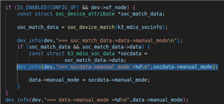

  • Hi Daolin,
    One way to check is to add a print statement in the davinci_mdio driver to see if data->manual_mode is true.
    I previously printed this value and found that during the C45 registration process, the callback function was null. I traced the process of this function's registration.
    [    0.187079] davinci_mdio 8000f00.mdio: === data->manual_mode =0

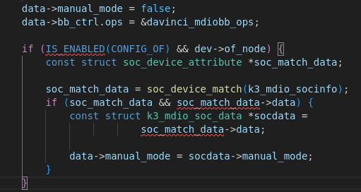

    Based on this output, it appears that your MDIO configuration is not in manual mode, which is a problem to reading the C45 registers (i.e. getting davinci_mdiobb_read_c45 to run). Can you check if socdata->manual_mode is also 0? (See below link)
    https://git.ti.com/cgit/ti-linux-kernel/ti-linux-kernel/tree/drivers/net/ethernet/ti/davinci_mdio.c?h=ti-linux-5.10.y&id=7fc3c8b9ad3952915b3bbba748f4d32a3622d325#n550
    -Daolin
  • Hi Daolin:
    [ 0.198956] davinci_mdio 8000f00.mdio: === soc_match_data->data->manual_mode
    [ 0.198971] davinci_mdio 8000f00.mdio: === data->manual_mode =0
    The issue now lies in the return value of the soc_device_match function.

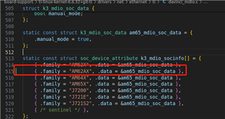

  • Hi Daolin,
    I have resolved this issue. I'm not sure why TI did not add a match for AM62AX in the davinci_mdio.c file.
    The modification is as follows:
    The questions are as follows:
    1. If so, I'd like to know why it wasn't added?
    2. Why is there a problem with driver initialization?
    Ranxi Ren
  • Hi Ranxi,
    Glad to hear you have resolved the issue!
    My understanding is that the MDIO workaround was implemented in 2022, at that time AM62Ax was not yet released (it was released early 2023), so it may have simply not been included because the soc itself was not available.
    I've noticed that even on the latest kernel release (ti-linux-6.6-y or SDK 10.0), AM62Ax was also not added to k3_mdio_socinfo[]. Based on this and your findings, it appears that AM62Ax MDIO was always running without MDIO bitbang/manual mode. This has been working without any issue because AM62Ax itself does not have an MDIO corruption errata (AM62x and AM64x does have this errata).
    However, the missing AM62Ax in k3_mdio_socinfo you discovered was exposed due to trying to read clause 45 registers which appears to require MDIO bitbang/manual mode. I will take steps to add AM62Ax in k3_mdio_socinfo for further SDK releases.

    To clarify, are you asking about the NXP TJA110 PHY driver or davinci_mdio driver? I see your screenshot of the NXP PHY driver so if you are talking about a problem with that driver I won't be able to help much because that is a part that TI doesn't support. You might consider contacting NXP directly about the driver initialization.
