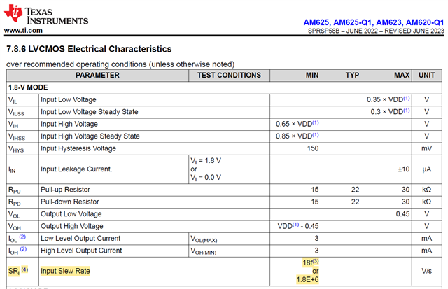

#1. Did not find MMC0 HS200 slew rate data in datasheet timing section, so section 7.8.6 LVCMOS Electrical Characteristics data applies?
#2. The Min vale: 18f or 1.8E+6, the two value are quite different, 18f=18x200MHz, 1.8E+6=1.8M for HS200, which is the right one for HS200?
#3. On custom board, the slew rate of read data with eMMC is about 1V/ns, see below picture, P5 and P6 for rising and falling edge slew rate, Is it acceptable for AM62x at HS200?
#4. How is the slew rate requirements specified? What impaction if lower slew rate signal?
  • 1) We only define Input slew rate for modes which have specific or fixed input timing requirements. The clock output to data capture time relationship is not fixed for the HS200 read data path since this mode requires data training. The data training algorithm used a known data pattern to select a data capture time that is centered in the data valid window. There is no specific input slew requirement since tuning searches across an entire bit time to find the center of the data valid window. However, the width of the data valid window is a function of input slew. The signal transition needs to be fast enough to provide a reasonable data valid window for the data training algorithm.
    2) It is very important to limit the amount of time the applied signal spends within the voltage region between VIHSS and VILSS. The minimum input slew rate limits are required to ensure long-term reliability of the input buffer.
    The minimum slew of 1.8E+6V/s (1000ns when operating at 1.8V) is not a function of toggle frequency and it represents the slowest signal that can be applied to the AM62x input buffer. The minimum slew of 18fV/s (0.5ns when operating at 1.8V with a 200MHz toggle) is a function of toggle frequency and represents the minimum slew rate allowed for a specific operating frequency. The limit of 18fV/s is the more restrictive of the two limits, so this is the requirement to ensure long-term device reliability. In some cases, a specific peripheral may have a more restrictive requirement to ensure timing.
    3) I would not expect an HS200 timing issue for read data with this signal slew, but it appears to violate the 18fV/s requirement.
    4) Input slew rate can impact long-term device reliability and input timing.

  • Hi Paul,
    Thanks, per customer's feedback I read upper again especially for #2. I split it to be better understanding for me.
    #1. 1.8E+6V/s is the slowest signal that can be applied to the AM62x input buffer
    [TT] 1.8E+6V/s=1.8V/1000ns
    #2. 18fV/s (0.5ns when operating at 1.8V with a 200MHz toggle) is a function of toggle frequency and represents the minimum slew rate allowed for a specific operating frequency
    [TT] 18fV/s=18x200MV/s=18*200/1000ns=3.6V/ns
