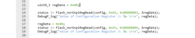

I imported ospi_flash_io application and successfully ran in TMDS64EVM board.
In this application, to write flash, sequence is as follows.
Flash_offsetToBlkPage(gFlashHandle[CONFIG_FLASH0], offset, &blk, &page);
status = Flash_eraseBlk(gFlashHandle[CONFIG_FLASH0], blk);
status = Flash_write(gFlashHandle[CONFIG_FLASH0], offset, gOspiTxBuf, APP_OSPI_DATA_SIZE);
I have to write flash only erase sector not block.
So I updated the above as follows,
Flash_offsetToSectorPage(gFlashHandle[CONFIG_FLASH0], offset, &sector, &page);
status = Flash_eraseSector(gFlashHandle[CONFIG_FLASH0], sector);
When I ran the above code, Flash_write error happen. I found out that Flase_eraseSector is not working correctly. When I read flash after Flash_eraseSector executed, couple of values are not 0xFF.
Please let me know how to write flash only erasing sector.
