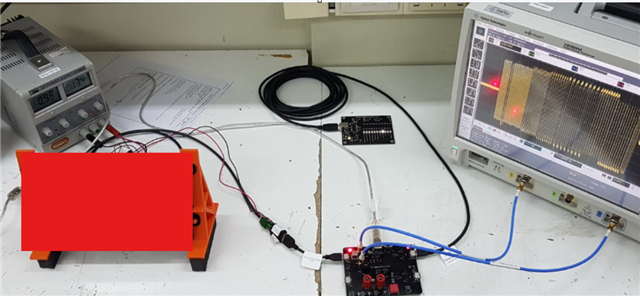

Hi, I'm using the DRA767P processor in an application featuring USB2.0 interface.
We run a preliminary test previous to USB-IF certification and we noted a slight deviation on the Eye diagram mask.
I wanted to know if there is any way to adjust physical parameters for USB PHY so we can pass this eye diagram test.
Thanks and regards,
Augusto.

    Can you describe (show pictures of?) your test setup (including equipment, cables, connectors)?
    Also provide a summary/image of your violation?
    Kyle
  • Hi Kyle,
    The setup used is based on TestUsb boards to enter the usb_packet mode and to connect the oscilloscope. I shaded the product due to confidentiality restrictions.
    The result can be depicted below. as you can see, we are marginally failing.
    Please let me know your comments.
    regards,
    Augusto.
  • Augusto,
    I see that the SMA cable connected to the scope is almost 18in; is there a shorter 6in cable that can be used instead, as it provides smaller insertion loss, resulting in a faster rising edge?
    https://e2e.ti.com/support/processors-group/processors---internal/f/processors---internal-forum/1324757/faq-dra7x-tda2x-omap5x-am57x-increasing-tx-amplitude-margin-for-usb2-0-by-tuning-the-termination-resistance
    This FAQ should apply to the DRA7xP too, and you could refer to this in case you need to increase the TX amplitude further to have a slightly higher margin on the near-end mask. Please let me know.
  • Hi Kyle,  thanks for your answer. The SMA cables used to run the measurement are part of the TESTUSB kit. I assume they are considered to be representative of what is going to be used in the final certification. I'm concerned about changing the cable, getting a pass and then being rejected by the laboratory.

  • Augusto,
    Here is the snippet of the USB drive eye mask improvement..
    "The fundamental idea would be to reduce termination resistance by a few counts to improve the eye diagram height. We would recommend tuning termination resistance first and then if that doesn‘t work it is recommended to optimize the channel USB cable.
    Address of registers
    Register
    Address in DRA742
    TERMINATION_CONTROL
    0x4a084000 (J6 USB2PHY2 - 0x4a085000)
    The register descriptions are below this text
    Adjusting termination resistance
    • Write 0 to TERMINATION_CONTROL.MEM_FS_CODE_SEL bits 27:24 in this register. This offset may be otherwise internally applied when the test pkt is being emitted. Make sure to do this step first because the value read in 5:0 will change once 0 is written to 27:24.
    • Read TERMINATION_CONTROL.RTERM_RMX (offset 0x00) bit 5:0.
    • Increase this value by 8-9 codes from the read value. 10 codes will provide ~2ohm decrease in output impedance. If untrimmed, you can use 21 as default. Depending on the exact system, you may have to go higher.
    Set TERMINATION_CONTROL.MEM_USE_RTERM_RMX_REG bit 21 as 1 and set the value from step 2 to MEM_RTERM_RMX (bit 20:15).
