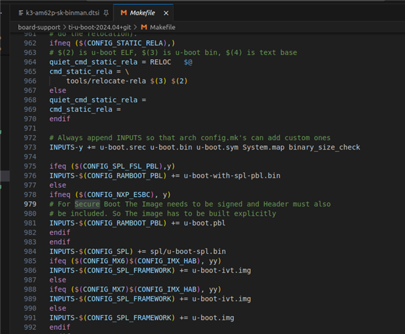

I want to use spl booting on a HS-SE device . Do I need signed on images ? If does ,what are the images to be signed and and how to signe them.
The secure boot is integrated in both MCU+ SDK and PSDK. You do not need to manually sign anything. Simply build U-Boot and run on the board. You should see logs like "Authentication passed" if the authentication of the different blobs passes.
I flashed "tiboot3-am62px-hs-fs-evm.bin" into board with ti official key and it's working.
I wonder when I use my personal key ,what should I do to make the tiboot3-am62px-hs-fs-evm.bin is using my personal keys.
Also,I see this line in SDK makefile. Do I really don't need to do anything?
For HSFS, the keys don't matter. If you have converted the device to HSSE and programmed your own keys then you would need to sign the images with your custom keys.
