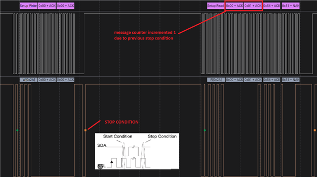

We are trying to access MAX 96714 Deserializer through I2C with 400KHz as baud rate on R5F.
We can able to write and read. But on looking wave form we are seeing 2 stop condition.
Kindly let me know if it is fine to have the I2C wave as below.
