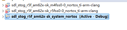

I did one test, I just imported sdl_stog_r5f_am62x-sk_system_nortos.
Then, the CCS will help me import the sdl_stog_r5f_am62x-sk_m4fss0-0_nortos_ti-arm-clang and sdl_stog_r5f_am62x-sk_r5fss0-0_nortos_ti-arm-clang.
So it seems I need to flash both of them

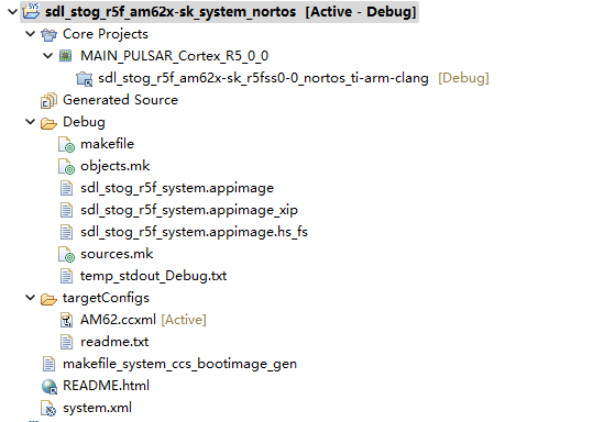

Are you trying to build the system project?
If yes, system project can not directly be loaded to cores via CCS. There will be binaries created for both cores M4F and R5F. You will need to load them both on respective cores.
Also there will be a combined appimage created which you can directly flash to the EVM.
