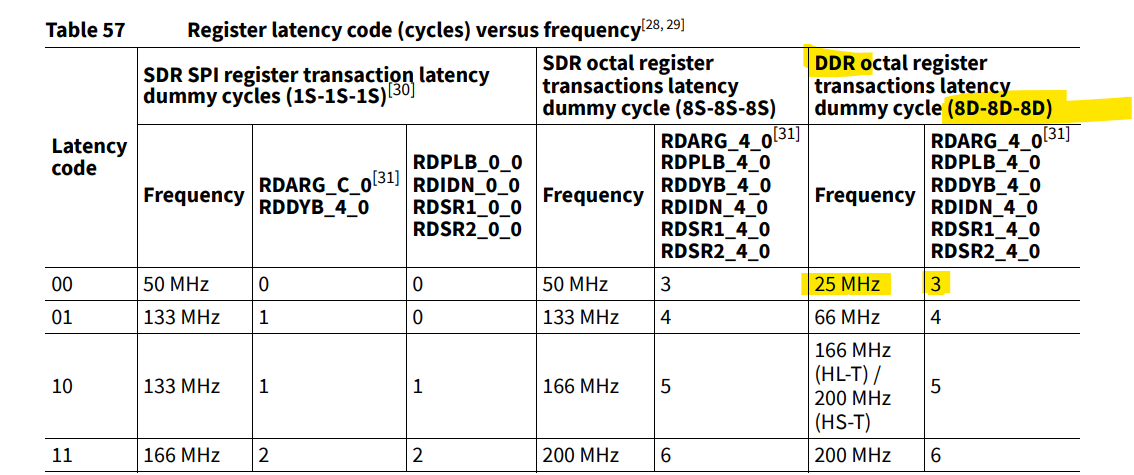

    S28HS512T (Frequency: 200 MHz, Divider: 8, Then based on the datasheet, the dummy cycles value will be 3)
    Part A: 9Fh + REPEAT(9Fh)
    Part B: 00h + 4 Address Bytes(32 bits)
    Part C: 3 dummy cycles(can be seen from the datasheet)(Screenshot below)
    Inside Flash_norOspiReadID, the equation becomes:
    status = Flash_norOspiCmdRead(config, idCfg->cmd(9Fh), cmdAddr(00h), numAddrBytes(4), dummyBits(3), idCode, idNumBytes);

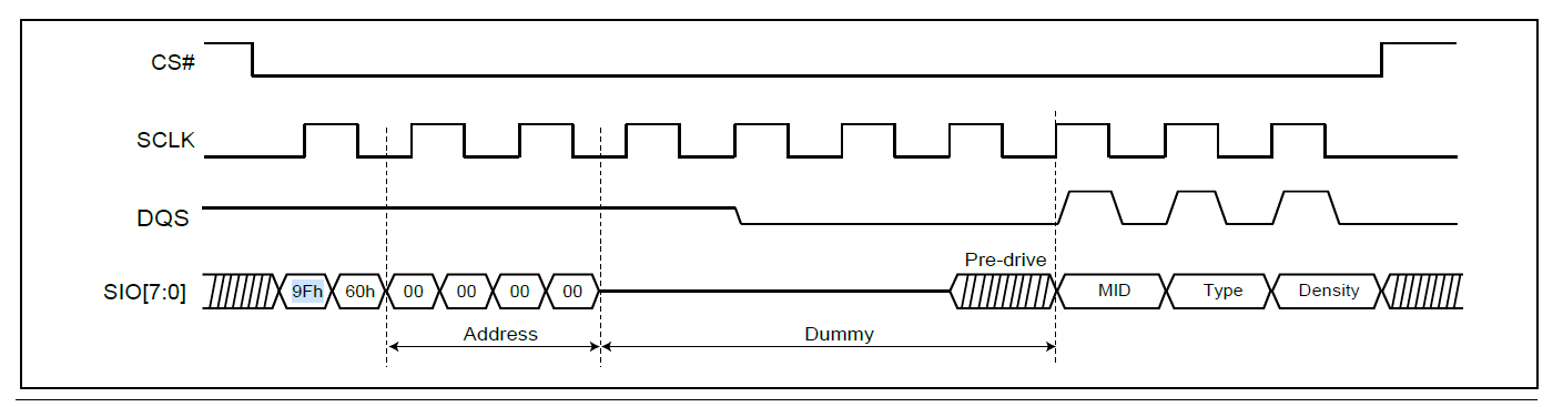

    MX25UW64 / MX25UW128
    Part A: 9Fh + INVERSE(60h)
    Part C: 4 dummy cycles(can be seen from the datasheet)(Screenshot below)
    status = Flash_norOspiCmdRead(configidCfg->cmd(9Fh)cmdAddr(00h)numAddrBytes(4)dummyBits(4)idCodeidNumBytes);

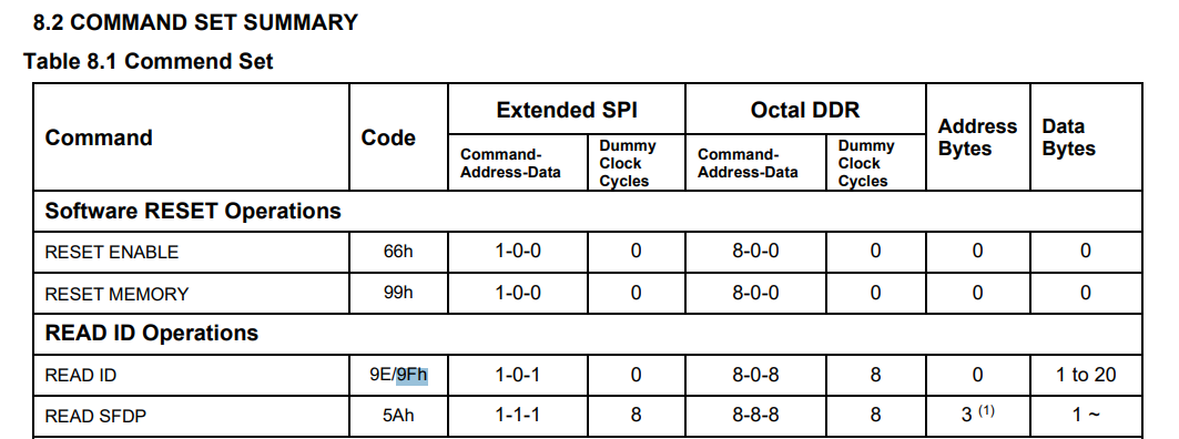

    IS25LX128
    Part B: OSPI_CMD_INVALID_ADDR (No Address is required)
    Part C: 8 dummy cycles(can be seen from the datasheet)(Screenshot below)
    status = Flash_norOspiCmdRead(configidCfg->cmd(9Fh)cmdAddr(INVALID)numAddrBytes(4)dummyBits(8)idCodeidNumBytes);
    Based on 3 different flashes demonstrated above, one can debug flash read ID API failures.
