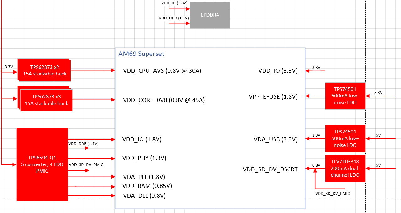

I'm working on designing a power tree for the AM69A and wanted to confirm that I was grasping all the voltage rail requirements. I have some questions below:
  • Which rails should be powered by LDOs vs bucks?
  • What is the VDD_SD_DV_DSCRT rail for?
  • Do I have all the voltage rails required for this device listed?
