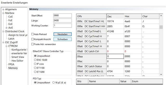

the configuration of the latch inputs to the single event mode does not appear to be possible via the PDI (register 0x9A8/0x9A9). There are no timestamps either.
In the "ESC" tab list, the tabs are shown as read-only. The registers can be written in the real ET1100 from Beckhoff.(See screenshots below).
When the PLC writes the registers, it works. But not every PLC (e.g. Omron…) can do that. Therefore customer would like to configure this in the FW.

    here are more information about latch. They want to use the digital input latch function. In the best case, configurable between continuous and single event mode.
    Register 0x980 is set to 0x0330. Therefore, the control of the latch in's should be at the PDI. The 0x0330 is also stored in the EEPROM in the category DC in AssignActivate.
    From the point of view of TwinCAT, the PDI is also in control:
    He wrioe the register 0x09a8 "Latch Control" with BSP_write_word(ECAT_PRU_HANDLE, 0x0303, ADDR_LATCH0_CTRL); .
    The value also arrives in the register after starting the firmware:
    In their view, single event operation should be activated. Latch0 is connected to SYNC0. There are no timestamps. If he wrote the ESC register 0x09a8 to 0 and then to 0x0303 again via TwinCAT, the timestamps come. Unfortunately, this does not work with firmware.
    When the register is set to 0, timestamps (continuous mode) always come.
    How can they activate single event mode from the firmware?
