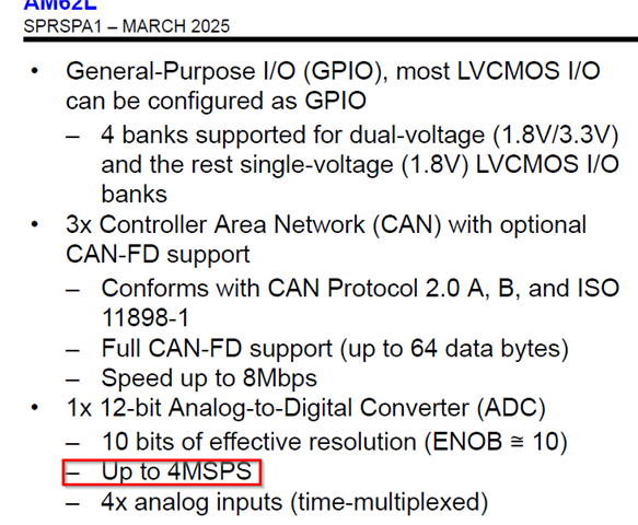

On March 2025 version data sheet it is 4MSPS,
but changed to 2MSPS on Sept. 2025 Version data sheet.
The customer need 1channel 4MSPS ADC, can it be supported by the on-chip ADC of AM62L?

Hello Tony,
The change was due to a typographical error in the AM62L datasheet. AM62L ADC goes up to 2MSPS.
If applicable, AM64x does support 4MSPS for its ADC.
