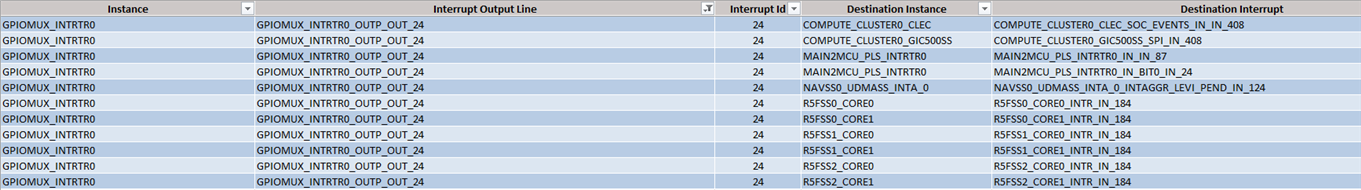

I have modify the rm-cfg.yaml to setup interrupt router [56 ; 63] to c7x_1 (host id 21) and recompile the u-boot.img + tispl.bin
Linux boot correctly
On c7x, the sciclient Sciclient_rmGetResourceRange return start interrupt router id 56 and range 8 (as expected)
The Sciclient_rmIrqTranslateIrOutput give the CLEC event id 440 (as expected)
But Sciclient_rmIrqSet return -1.
When I launch the same c7x code in no boot mode it works (after updating sciclient_defaultBoardcfg_rm.c and using boardcfg_update.sh)
I am missing something when I boot on linux ?

  • Hi Takuma,
    It should not be a resource conflict. GPIO have 64 interrupt routers (from 0 to 63) :
    • router allocated to A72 [32 ; 55] (default config)
    • router allocated to C7x_1 [56 ; 63] (my config, was free in default config)
    If it is a resource conflict, it means that linux is using other cores' resources.
    Charles

    The solution :
    Each interrupt router have several output which are always enable (each output can be used individually)
    ex for interrupt router 24 :
    The A72 interrupt come from the GIC and the C7x interrupt come from the CLEC.
    Therefore to enable the gpio bank interrupt on c7x side : use the same interrupt router as the linux
    get the interrupt router used by linux (from your config rm-cfg.yaml), get the CLEC event id associated (from the appendix doc)
    and then config the GPIO interrupt reg (located at 0x00600000 for module gpio0), config the CLEC event + c7x core interrupt.
    Don't config the interrupt router, it will be config by the linux.
    Charles
